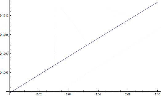

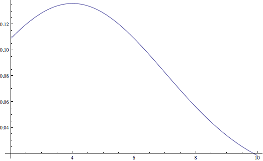

To find the probability of x=2 I think maybe we could substitute.
[tex]p_x(2)=\frac{1}{3 \sqrt{2\pi}}e^{\frac{-(2-4)^2}{18}}[/tex]
[tex]x^2\sqrt{x}[\tex]<br /> was trying some latex here. semi-success.[/tex]
Substituted the value for x=2 in my Casio and I get 0.1064826685.
Will try and plot in Mathematica for confirmation.
Plotted :)
Not sure quite how to embed the image so that it appears in this post. But its attached & the hand-calculated value looks reasonable :)

yes! Think this is how its done.
