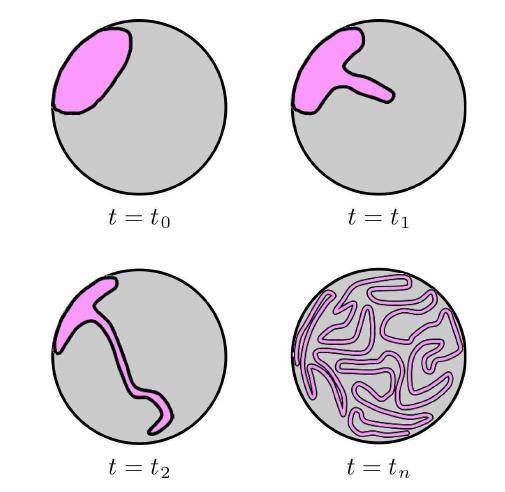

My understanding of the Boltzmann's H-theorem is that if a set of a large number of colliding bolls is not in the thermodynamical equilibrium (i.e. the probability distribution function W doesn't obey the Maxwell distribution), its entropy will grow (without supplying heat) until the equilibrium is reached. On the other hand, the Gibbs entropy defined as the integral of W*logW over all phase space is a constant of motion regardless of the system being in thermodynamic equilibrium or not (the latter is a direct consequence of the Liouville equation). How does this two statements reconcile?

Gibbs entropy undertakes coarse graining by finite small volumes of phase space, not integral but sum, I think. Volume unit of h^3N from QM corresponds to it.
The key is to distinguish fine grained Gibbs entropy from coarse grained Gibbs entropy. The former is a constant of motion. The latter isn't.
The picture illustrates how the fine grained volume (in phase space) remains the same during the evolution, while the coarse grained volume increases. Thinking of Gibbs entropy as the logarithm of volume in phase space, this explains how the fine grained entropy remains the same, while the coarse grained entropy increases.
