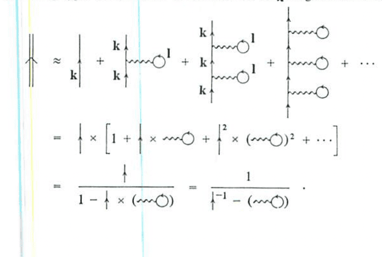

Now, adults prefer to use some diagrammatic calculation
(from Mattuck A Guide to Feynman Diagrams in the Many-Body Problem) which leads to the propagator
##i G (k,\omega)= \displaystyle \frac{1}{[iG_0(k,\omega)]^{-1}-(-1)(-i)(-1)\sum_l V_{klkl}}##
or simply
##G = (k,\omega)= \displaystyle \frac{1}{\omega-\epsilon_k+i\delta -\sum_l V_{klkl}}##
where you can read directly from the denominator that the energy is going to be the same as the one from perturbation theory. That's why both methods are called Hartree. Same happens with Hartree–Fock term.

Basically, Feynman diagrams are related to a perturbation expansion of the resolvent (H-lambda)^{-1} and not of the hamiltonian itself. So it is not astonishing that a first order correction to energy yields a geometric series for the resolvent and vice versa to get exactly coincident expressions.
Can you expand on this or give a mathematical example?
Well, if ##H=H_0+\epsilon V## and ##R=(H-\lambda)^{-1}## and similarly ##R_0##, then the one particle Greensfunction is something like ##G=\langle 1 | R| 1\rangle> ## where ##| 1 \rangle ## is some one particle state. Expanding R in powers of ##\epsilon## yields the Dyson equation for ##G##. If you only insert 1 particle states, this gives a geometric series. Summing the series yields the same result as Brillouin-Wigner perturbation theory for the Hamiltonian (which by the way, in deed infinite orders as the denominator does not contain the unperturbed E_0 but the perturbed E.
