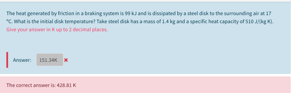

Hi everyone
This is a quick Q but I don't understand why I got it wrong
This is what I have done
Could anyone let me know where I went wrong? Thanks for any help!

This problem statement makes no sense to me. What idiot dreamt this up?

Yeah, it's a very poor question. I suspect what they were trying to describe was a process in which all the heat dissipated during the braking goes into raising the temperature of the steel disk to some temperature ##T##, and then the disk is allowed to cool whilst in thermal contact with the constant temperature surroundings to a final temperature which approaches the temperature of the surroundings. Definitely quite an artificial setup, and not very physical!

Note that -99,000/1.4*510 is also ambiguous. Are we supposed to multiply by the 510 or divide? The rules (PEMDAS or BEDMAS) prescribe multiplication. But it is pretty clear that we want division in this case.As I understand the problem we have a steel disk that dissipates 99 kJ of heat energy, ending at a temperature of 17 C. We are asked for the disk temperature prior to this loss of heat.
So we:
1. Convert the final temperature to Kelvin.
2. Compute the temperature difference due to a transfer of 99 kJ of heat energy.
3. Add the temperature difference to the final temperature to arrive at the initial temperature in Kelvin.
$$(17+273.15) + \frac{99000}{1.4 \times 510} = 428.81 \text{K}$$
