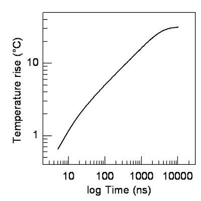

I have the following problem and would appreciate any help you might be able to give.
In reality, I have a 2D/3D problem (self heating of a semiconductor device), but I'm absolutely happy if I would understand the 1D simplification:
I have a rod of length L (semi infinite would be even better). One end is at a fixed temperature (heat sink) and the other end is attached to a electric heater with constant power. The entire rod is at the temperature of the heat sink at time t=0. Then the heater is switched on. I'm interested in the temperature T as function of time at the place of the heater.
I ran thermal simulations of the problem which suggest that T is proportional to t0.58 (1D); t0.38 (real 2D) for the initial heating. But why?
I guess there is an analytical solution for it where you can see the relation ship, but I wasn't able to find any.
Thanks for your help

I got the power dependence when I plotted the 1D and 3D simulation (Temperature vs. time) in a log-log-plot. I get a nearly perfect straight line. It might be just a coincidence, or it might be an approximation of the analytical solution.
Hmm, that's suprising. Perhaps you could let the simulation run longer, and see if the 1D case approaches the solution I mentioned in post #4 for long times. According to that, the temperature at the heat source should approach, but never exceed:
Tmax=Tsink+(P L) / (k A)
However, if it follows the t0.58 dependence, eventually it would exceed that temperature. So this would be a good test of the t0.58 curve vs. what I gave in post #4.
Are you looking at the temperature at a specific location, or some kind of average over the rod's length?
Dear Redbelly
I'm interested in the temperature evolution right at the location of the heater.
When I let the simulation run for longer it converges as expected to your Tmax
Have a look at the graph.
http://picasaweb.google.com/franck.hertz/Forum#5262954245291443458
To me, the beginning and the middle part look pretty straight (in log-log) plot, i.e. it follows a power dependence, but why? I guess it must be an approximation of the analytical solution (which I unfortunately don't have).

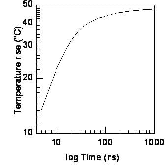

Dear Redbelly
Yes, you are right, I'm in Europe (UK).
I checked the input parameters of my 1D simulation. The thermal parameters are of GaN:
k=1.9 W/cmK (thermal conductivity)
\rho=6.1 g/cm3 (density)
c=1.49 J/gK (heat capacity; not of GaN. GaN would be 0.49, it was a typo)
P=0.03W power
A= 100um2 (Cross section)
L=10um (length).
Regarding a 3D simulation: I need to check if I can easily construct a sphere. All my thermal models are blocks so for, but I'll try so that you can compare it with your calculation.
I managed to get a 3D sphere working in the simulation, but I don't know how accurate it is a it is a simple model (i.e. low mesh density)
I assumed a point heater at the center. This would lead to an infinite temperature, which is not sensible and the simulation tool does some sort of averaging. Therefore extracted rs by fitting Redbelly's Tmax. =>
rs=0.39um
R=10um
P=0.03W
and thermal parameters as above
With this I get
t1 = (c ρ / k) rs2=7ns
and/or
t2 = (c ρ / k) R2 =4.8us
It seem that t1 is too short and t2 too long.
http://picasaweb.google.com/franck.hertz/Forum#5264420670106402930

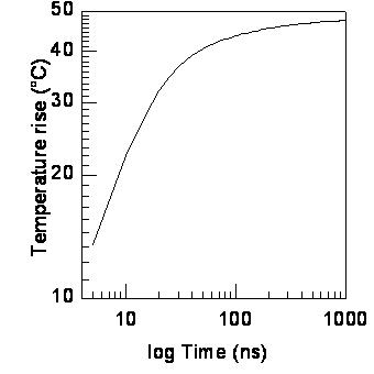

Running out of time this morning to post the graph, but using your 1D numbers:
I get 15.8 C for the max temperature rise as t→∞
At 4.78 us, the temp rise is 14.7 C
1D simulation
Franck said:
Code:
P=0.03W power
L=10um (length).
Using those parameters, (c=1.49 J/g-K, not 0.49) I get:
Time units are seconds.
My temperature is about half of what you got before, not sure why that is so. The time scales match up pretty well:
