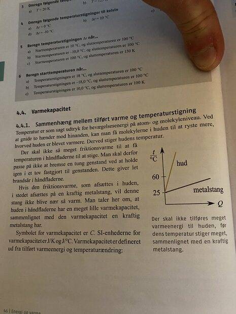

Here you go. Here are the pictures requested. If you read from 4.4. (heat capacity), you can see it is written. I think there are some online softwares which can analyse text on pictures if you want it translated :)

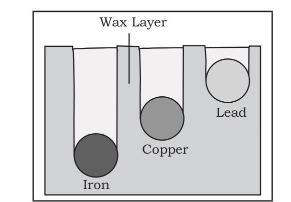

I respectfully agree, the example of the book could use some improvement: comparing two bodies (copper and aluminum) of similar dimensions should suffice.
For example, the experiment shown in the picture, shows that three bodies of similar mass and different metals, all with similar initial temperature, melt different volumes of wax.
As you can see, the iron sphere accumulated and then liberated more thermal energy than the other two spheres.

Thank you for posting the pictures. I translated the figure caption in the first photo:
Danish
Der skal ikke tilføres meget varmeenergitil huden, før dens temperatur stiger meget, sammenlignet med en kraftig metalstang.
(Googletranslate said that "dens" above should be "dets". Is that accurate?)
English
Not much heat energy needs to be applied to the skin before its temperature rises a lot, compared to a strong metal rod.
Since you are interested in learning about this, let's do a sample calculation. The heat capacity ##C## is the mass of the object multiplied by the specific heat ##c## which is something that is measured experimentally and depends on the composition of the object. The specific heat of water is 4200 J/(kg °C) and the specific heat of iron is 450 J/(kg °C) and the average specific heat of the human body (which is mostly water) is 3500 J/(kg °C). I looked up these numbers on the web. Now the key equation to use here is $$Q=mc\Delta T$$ where
##Q=~## the heat added to the object
##c=~## the specific heat of the object
##m=~## the mass of the object
##\Delta T=~## the rise in temperature of the object when amount of heat ##Q## is added to it.
Now let's see how much heat is needed to raise by 1 °C the temperature of a hand that has mass 0.5 kg and compare that with an iron rod of the same mass.
##Q_{\text{hand}}=0.5~(\text{kg}) \times 3500~(\frac{\text{J}}{\text{kg}~^o\text{C}})\times1~^o\text{C} = 1750~\text{J}.##
##Q_{\text{rod}}=0.5~(\text{kg}) \times 450~(\frac{\text{J}}{\text{kg}~^o\text{C}})\times1~^o\text{C} = 225~\text{J}.##
It takes 7.8 times more heat to raise the temperature of the hand by 1 degree. This seems to contradict the caption of the figure that I translated. This conclusion follows from the calculations which assume that in both cases the heat that is added is distributed equally over the entire mass of the object and that the temperature is the same everywhere inside each object as heat is added. In reality, as I indicated before, when you rub your hands together the heat stays on your skin and is diffused slowly into the body via the bloodstream. The iron rod, being a better conductor of heat, carries the heat into its interior much more quickly.
I do not understand the context of what the textbook is trying to say in that passage therefore I cannot conclude that the book is wrong. Instead I tried to explain to you what I know is correct.

So, I am not native in Danish, but I am in Swedish which is fairly similar (at least the written language).
Dens vs dets: Variations of the same word that is conjugated based on the gender of the noun it refers to. In this case "hud" (skin) in definite form "huden" has common gender making "dens" the correct form and Google Translate incorrect - possibly caused by the punctuation.
"Kraftig" has (at least in Swedish) several similar meanings. The meaning here is likely more "thick" than "strong" and drawing the mind towards something pretty heavy - significantly more heavy than a hand - making the comparison of equal mass objects unlikely as the intended comparison. (I'm not saying it is pedagogical, just interpreting what the author might have intended.)
With your fair understanding of Danish and your excellent understanding of physics pedagogy, what would you say the intended comparison is and what point is its author trying to make? I cannot deduce that based on physics alone.
the text is even confusing on a volumetric basis. The specific heat of steel is close to 1/8 that of water; yet the density is close to 8 times. so the volumetric heat capacity of steel and water are nearly identical. 60 vs 62 Btu/ft3-F (pardon my US engineer accent here).
EDIT steel at 4.02MJ/m3-K vs water at 4.16

As Orodruin said. "dens" is just a word used to refer to what is being said. "dens" is referring to THE HAND(s). I was under the impression that heat capacity is how much joule is needed to make the surface (or the whole) of the hand hot. So it would take fewer joule to make your hands 100 degrees celsius and therefore less time than a metal rod.
In general a "metal" has a lower specific heat capacity than flesh (which is mostly water). "Specific" here means "per kilogram" of material. So a given mass of metal shows temperature rising faster than the same mass of water (given the same heat input).

My textbook just says the opposite. That the surface (the flesh) of the hand has a lower heat capacity than the metal rod.

The book is talking about heat capacity, not specific heat capacity. With a thick metal rod, it supposedly has significantly higher mass than the skin of your palm unlike the equal mass example presented in #14 or the specific heat discussed in #19. While the book may not be directly wrong, the example is not very well chosen and possibly misleading.

So, to be 100% clear. Heat Capacity (not specific heat capacity) is the amount of energy (if we measure it in Joule) that is needed to raise the temperature of an object (where object is ANYTHING THAT CAN BE COLDER OR MORE HOT) by 1 degree celsius. Is this ONLY the surface area that we are talking about, or the WHOLE object, like the whole metal rod (both inside and outside) that are being being more hot?

Of course it does. Your book is, in a sense, comparing apples and oranges which, for someone like you who tries to understand these concepts, could be confusing. The issue can be resolved by comparing apples with apples which is where specific heat comes in.
I just noticed that @Orodruin already said what I was going to say, so I will stop my explanation here.
However, I note that in your original post you asked about the "hand" getting warmer,

Now I think you understand that "skin" and "hand" have different heat capacities and more or less equal specific heats so when you touch something hot at first the heat goes into your skin and not your hand. Likewise, if you place a metal pot on a hot stove, the heat first goes into the surface of the pot. A layer of metal equal in thickness to a layer of skin of equal mass will heat up more quickly than the skin because it has a lower specific heat and therefore requires fewer Joules of energy for its temperature to rise by one degree.

The entire object as a whole. Then the question becomes what you consider an ”object”. The treatment with heat capacity assumes an object in internal equilibrium (so homogeneous temperature). If your heating process is fast and you look at time scales shorter than the typical time for the object to equilibrate, then you need to start solving partial differential equations.

And just to be completely sure. "requires fewer Joules of energy for its temperature to rise by one degree." are you here talking about ONLY the surface of the pot or the whole pot? Just to be sure if heat capacity is talking only about the surface area of an object or the whole object.

Whole object. You should be able to see from the equations why the idea makes no sense to say for a surface. It's for an object with mass and volume so in effect a surface has zero capacity to store heat.

If you look at post #3 made by hmmm27 you can see why I was confused, since he talked about the surface (while my original example was the palm of your hands).

It's a symptom of the poorly chosen example in the book. Usually to start with this concept you talk about uniform heating of an object. When rubbing your hands together you are heating part of an object (you), unevenly. Here, the "surface" of your skin is actually some thin but non-zero thickness of skin.
