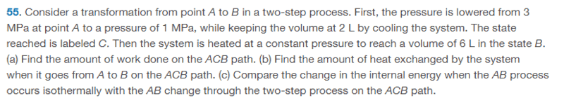

For part(b),
My solution is,
##\Delta E_{int} = Q - W = \frac{3}{2}(P_fV_f - P_iV_i)##
##Q = W + \frac{3}{2}(P_fV_f - P_iV_i)##
##Q = 4000 + \frac{3}{2}((1 \times 10^6)(6 \times 10^{-3}) - (3 \times 10^6)(2 \times 10^{-3})##
##Q = 4000 J##
However, according to the solution b. ##−4000 J##
Can someone please tell me what I did wrong?
Many thanks!

I'm uncertain what would in general be meant by the amount of heat "exchanged" by a system. It could mean the amount gained, the amount lost, or the magnitude of the transfer (so positive). Looks like they intended the amount lost.

Your answer is correct.

If they intended for the amount lost, why dose the first law in my answer give the wrong sign? If you don't know, please don't worry about it, this textbook dose have a lot of mistakes!

Thank you for your reply @Chestermiller ! That is reassuring. Do you please know whether the reason I am correct is because the textbook solution is wrong?

Obviously
