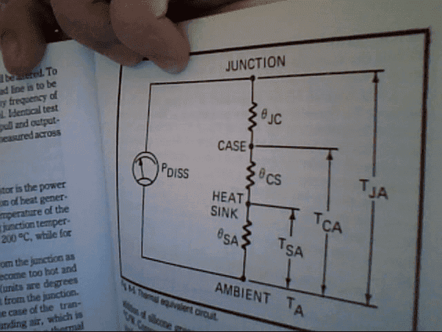

maybe this will help, I generally don't do the math for other people.
Thanks a lot for that picture.
Unfortunately your kind efforts have been in vain. I don't understand how that picture can help me.

Hi,
What I would do: take the surface of the box as a heatsink. You can find some clues about calculating a thermal resistance of some kind of heatsinks/surfaces: also, you can combine the resistances and calculate the resistance of the box. By using the definition of 'thermal resistance' you might get the difference of the ambient internal and external temperature.
Hi,
You need to calculate the internal, enclosure wall and external thermal resistances of the enclosure sum these values and multiply it by the amount of heat dissipated by the internal heater. These resistances are determined by the enclosure dimensions, enclosure material thermal conductivity and surface emissivity. The calculations are too lengthy and detailed to explain here. Check out the article below that provides the detail. Keep in mind that this is for steady state only.
[PLAIN]http://www.heatsinkcalculato...e-the-temperature-rise-in-a-sealed-enclosure/[/PLAIN]
http://www.heatsinkcalculator.com/blog/how-to-calculate-the-temperature-rise-in-a-sealed-enclosure/
