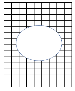

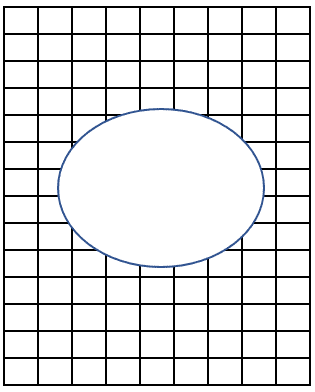

It's because the steel expands uniformly. Go back to the picture of atoms on springs. All the springs get longer by the same fraction. It's just a scale factor. (It would be very different if the heating were not uniform or the material of the plate was not uniform.)
So this
becomes this.
Note that, in terms of "number of intersections" the geometry is exactly the same after the stretch. 9 wide by 14 high. Each rectangle the same ratio. And the round hole is exactly the same number of intersections wide and tall as before. Only now each intersection is farther apart. So the hole gets bigger in exactly the same ratio.
Note that it means that any shape you draw on, or cut out of, the plate will also grow by the same scale.
