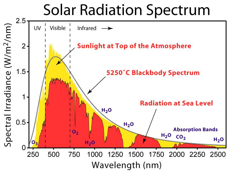

Because the atmosphere is more or less transparent to visible, less so to near infrared. The image below depicts solar radiation at the top of the atmosphere versus that at sea level. The difference between the two is incoming solar radiation that is either absorbed by the atmosphere or reflected back into space by the atmosphere or clouds. Only 19% of the incoming solar radiation is absorbed by the atmosphere; 30% is reflected back into space.
Most of the incoming solar radiation is absorbed by the ground, not the atmosphere. This energy is transferred to the atmosphere in the form of rising air, latent heat in water vapor, and thermal radiation. Only a tiny bit of the thermal radiation emitted by the ground makes it all the way through the atmosphere into space.

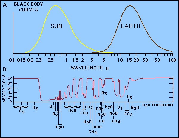

The atmosphere of the Earth extends much farther out than the troposphere.The troposphere is heated mainly by the surface of the Earth and the temperature decrease with height. Above the tropophere, the ozone in the stratosphere absorbs UV radiation, and temperature increases with height. The mesophere, where temperature decrease with height, has the coldest temperature on the planet where at the top it averages -85C.
As Chestermiller stated, oxygen and ozone molecules absorb radiation. At the surface, most of the UV and above frequencies such as x-ray have already been absorbed in the atmosphere.

Sorry algr. I was only trying to comment on that the variation of temperature with elevation is not a direct relation. The upper atmosphere will absorb most of the shorter wavelengths direct from the sun, of which there is not all that much if you look at the graph of the Solar Radiation Spectrum provifded by DH, and the lower atmosphere by ground heating as per the explanation by DH directly below the graph.

I think you have that around the wrong way
Its the Ozone layer that protects us from UV radiation
hence why us poor people in NZ and Australia get hit with more UV because of the Ozone hole
look at the chart DH posted O3, Ozone is up in the UV section

Look at that chart again, Dave. What you're talking about is but a part of the ozone-oxygen cycle. Ozone molecules absorb incoming UV-B (mid-energy UV) and split into ordinary oxygen molecules and atomic oxygen. That atomic oxygen usually reacts with other ordinary oxygen molecules to re-form ozone. This makes for a nice catalytic cycle that removes UV-B (and some UV-A) from the incoming solar radiation.
Sometimes two oxygen atoms will collide and form oxygen, sometimes with something else. If the cycle above were all there was to the ozone-oxygen cycle these depletion events would quickly drain the stratosphere of ozone. Ozone can also be depleted. Ozone can combine with a monatomic halogen to form a temporary species, which in turn combines with another ozone molecule to form ordinary oxygen and monatomic halogen. Yet another catalytic reaction, only this time the catalyst removes ozone. This is the primary manmade cause of ozone depletion.
Fortunately, there are also ozone creation events. Look at the chart. High energy UV photons dissociate ordinary oxygen molecules into monatomic oxygen. That monatomic oxygen combines with ordinary oxygen to produce ozone. Unfortunately, ozone is only created when the Sun shines. The Antarctic has a six month long winter when the Sun doesn't shine and the monatomic halogens have free reign to deplete the ozone from the far southern stratosphere.
