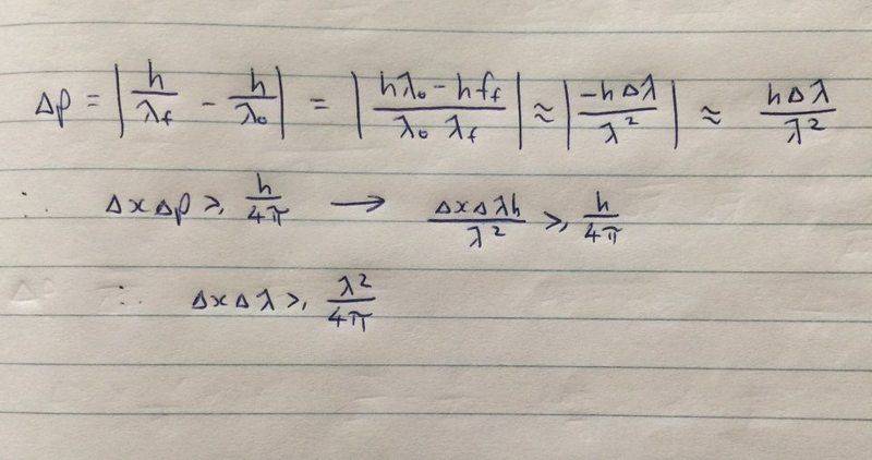

Show that ## \Delta\lambda\Delta\ x>lamdba^2/4*pi##
When I substitute de Broglie's p=h/lambda I get the equation of
##\frac {\Delta\x}{\Delta\lambda} > 1/(4*pi )##
You need to show more of your work. How are we supposed to tell where you went wrong if you only provide us with your final result? (I anyway have a pretty good idea of where you have gone wrong, but I want to see exactly what you did first.)

Here is my working

The first row is not correct. ##p = h/\lambda## does not imply ##\Delta p = h/\Delta \lambda##. What is ##d\lambda/dp##?

I have attached a worked solution in which I came to the right answer so I believe it must be right. However, I still don't understand intuitively why ##p = h/\lambda## does not imply ##\Delta p = h/\Delta \lambda##
Because it is a matter of how a small change in ##\lambda## changes ##p##. If you used your formula, a small change in ##\lambda## would give a huge change in ##p##.
If ##\ \ y = {1\over x}\ \ ## then surely ##\ \ {dy\over dx} = -{1\over x^2}\ \ \Rightarrow \ \ dy = -{dx\over x^2}\ ## . Change d to ##\Delta## and voila !
