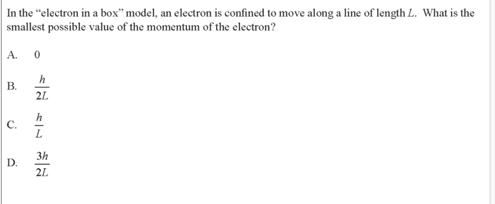

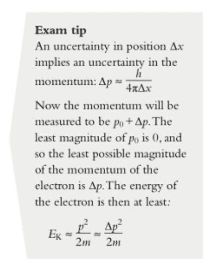

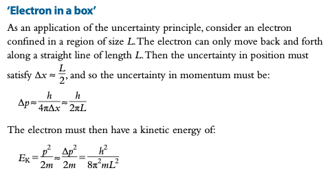

My first thought to solving this is to use Heisenberg's uncertainty principle. $$\Delta x \Delta p = \frac{h}{4\pi}$$ Now, we approximate ##\Delta x = \frac{L}{2}##. Then, plug and chug we end up with:$$p =\frac{h}{2\pi L}$$
I thought this was it, especially because this solution is in my physics textbooks

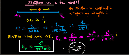

This is also seen from a friend's teacher's work:
However, very clearly, this is not an option. So then I considered the "standing wave" method, outline here: From 11:00 to 16:00
With this method you get $$p = \frac{h}{2L}$$
What is the correct method? What is happening? When do I use uncertainty principle and when do I treat the electron as a standing wave? Are they inconsistent?

Definitely the standing wave method is the one to go with here and B is definitely the correct answer. If you watch the video a little beyond the 16 min mark, he actually looks at a question very similar to this one.
As @Delta2 points out, it's asking for smallest value of p, not Δp.

To summarise:
1) This is Quantum Mechanics; and the correct approach is the fully quantum mechanical one: system - ground state - momentum.
2) The above exam tip is, at best, a shortcut that takes advantage of a numerical coincidence in such a simple system. And, at worst, an abuse of the principles of QM. Thinking like that in QM is a dead end, as it cannot be extended to systems generally.
Note that all the uncertainty in the momentum is directional. E.g. if we take the ground state energy of $$E_1 = \frac{h^2}{8mL^2}$$ then we have two possible, equally likely, values of momentum: $$p = \pm\frac{h}{2L}$$ Note that there is no uncertainty in the magnitude of momentum, only in the direction of the momentum.
Now, to compute the uncertainty in ##p## we have: $$\langle p \rangle = 0, \ \ \text{and} \ \ \langle p^2 \rangle = \frac{h^2}{4L^2}$$ Hence: $$\sigma^2_p = \langle p^2 \rangle - \langle p \rangle^2 = \frac{h^2}{4L^2}$$ And $$\sigma_p = \frac{h}{2L}$$

You've got it essentially correct. It turns out this problem is a bit more complicated when you look into it more deeply (posts 17, 18, and 19), which can cast some doubt on the stuff said in earlier posts, but you can ignore that for now.
There are technical definitions of ##\Delta x## and ##\Delta p##, and if you calculate them for a given state, you'll find they satisfy the uncertainty principle. (Post #8)
But as you did, you can also estimate ##\Delta x## based on physical grounds, and then use the uncertainty principle to obtain an estimate for ##\Delta p##. For the particle in a box, you also know the average momentum is 0, so ##(\Delta p)^2## gives you an estimate of ##p^2## and therefore ##\lvert p \rvert##. (Post #16 in reverse.) But your results here are going to be estimates, so you shouldn't be surprised that using it didn't yield one of the answer choices. (Post #7) Moreover, this line of reasoning didn't consider the state of the particle at all, so that's another clue it will yield at best an estimate rather than an exact value.
Looking at the wave function, one might attribute a wavelength of ##\lambda = 2L## to the ground state. Using the deBroglie relation, you then get ##\lvert p \rvert = h/\lambda = h/2L##. Or if you look at the ground-state energy and set that to ##p^2/2m##, you find the same result. This was the intent of the question, which should have more correctly referred to the minimum magnitude of the momentum (but that bit of sloppiness in language is fairly common).
