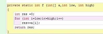

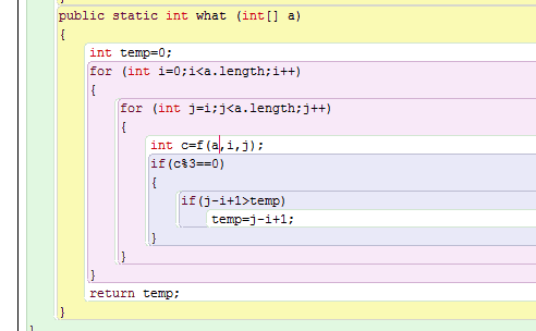

Hello everyone,
Looking for a more efficient solution to method 'what', in terms of run-time complexity and space.
The method finds the largest cell sequence that the organs sum is divided by 3.(Correct me if I'm wrong)
As it seems runtime complexity here is O(n ^ 3).
I came to solution of O(n ^ 2), is there a more effective solution? Explain please,
Thanks for the helpers !
Technology news on Phys.org
It seems you are resumming things over and over in the f method
f(a,0,3) means sum elements a[0..3]
then you do f(a,0,4) which means sum elements a[0..4]
why not remember the sum and just add a[4] to it?
This will eliminate the innermost loop in the f method.

I need to find algorithm to method that return the size of largest sequence that his amounts divisible by 3, in O N complexity..
for example, for array {0,0,1,1,1,1,1} the method return 5 . {0,0,1,1,1}
