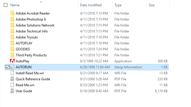

I just bought a new 7th gen I5 laptop. I am trying to load an old Adobe photoshop 6.0 I bought 18 years ago. It is a legitimate copy I paid $600 back in the days, I have all the serial numbers and all. But it won't install. I have read through a lot of suggestions on web. One problem is there is no setup.exe, it has an Autoplay only.
I try right click and click "troubleshoot compatibility" and I choose XP service pack 3, or try other and it won't work. I tried run as administrator, it did not work.
I am pretty sure the Photoshop 6.0 is 32 bit as it was out in 2000. Please help.
I have other programs that are just as old and very expensive also, I have no intention spending $thousands to buy new programs where the old one serve me just fine.
If all else fails, can I revert to Win 7?
Thanks
As I recall, it's not the 'Autoplay' what you need but the 'Autorun'. That is supposed to be an executable batch file. You should be able to start it manually (double click), or worst case you can read it (it should be a text file) and check where is the setup.exe hidden. Because that one should be there too, maybe within one of the directories.
Ps.: I would expect the relevant setup.exe to be in the 'Adobe Photoshop 6' directory.

This one doesn't have setup.exe. I have the Avery CD also I cannot install as it does not have setup.exe. My other software that has setup.exe worked. Problem is most of the instructions I read online in dealing with old program is for programs with setup.exe, that's why they really don't help me at all.
I tried installing directly from the CD, it behaved the same, I read an instruction telling me to copy into the computer and try again. That's the reason I copy onto the desktop.

Autorun is the batch file in the main directory of the CD which starts automatically after the CD inserted.
Autoplay is the OS function. Pease try to start the autorun file manually, and/or check its content.

The file list directory on the CD is show in the picture in post #1. You can see that's all it has. I opened each of the folder, there is no setup.exe.
If you mean double click the Autoplay in the CD manually, I did, that's the only way to even get started. It will show the first screen asking me to click install. But when I click "next", nothing happens anymore, it's just do nothing.
When I run in competitive mode, that autoplay will start too, just do nothing after the first "next".
The name does not necessarily the good old 'setup.exe'. It can be something else. That's why I asked the file list of the relevant 'Adobe Photoshop 6' directory.
Well, that might be an indication that the CD actually works. There is a known problem with win10 and 16bit installers, a solution described here: https://www.groovypost.com/howto/enable-16-bit-application-support-windows-10/
Ps.: as it seems In case of 64bit Win10 there is no solution other than a virtual machine: https://answers.microsoft.com/en-us...-windows/50497e46-707e-42b4-af7f-539037f5d0a0

I open the Autoplay and look, this is what's in it:
[autorun]
open=AutoPlay.exe -c
icon=Autoplay\ps5cd.ico
I type in Autoplay.exe in cmd.exe, it said it cannot find the program.
