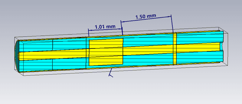

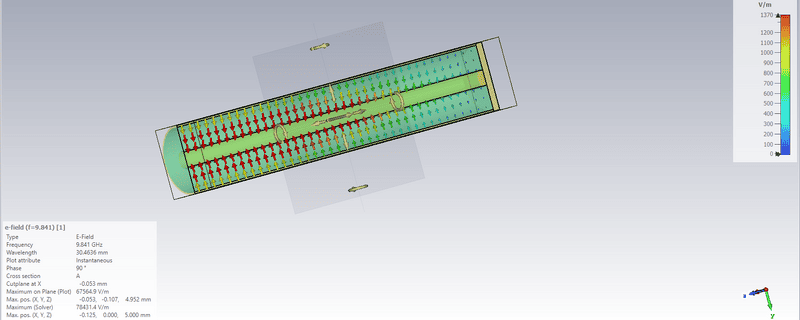

Hello , I have created a resonator as shown below in CST.

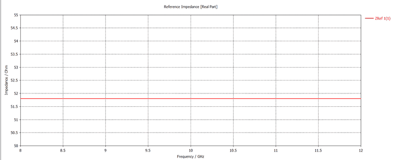

The waveguide port automatickly sets impedance as he sees along the line.

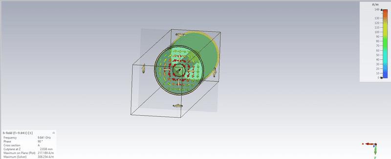

I got a TEM mode of quarter wavelength as shown below.
However the matching is very bad.
Where did i go wrong creating this resonator?
Thanks.

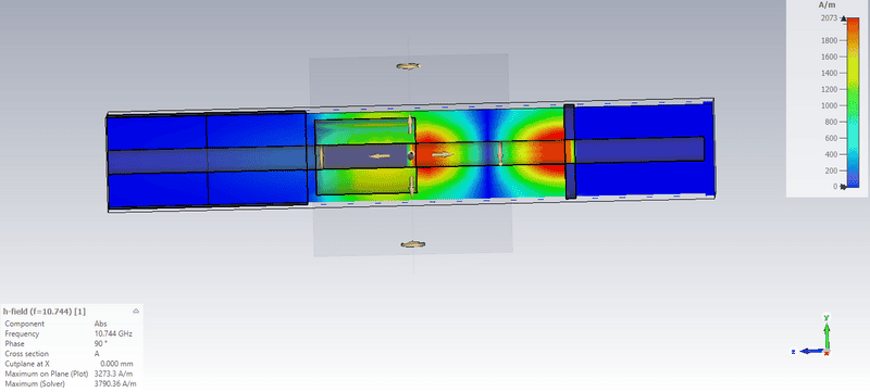

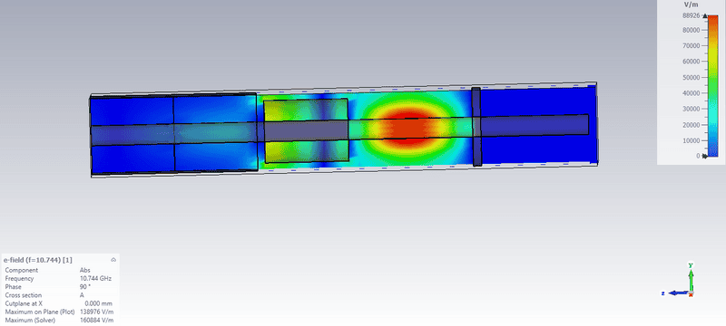

E-Field:
The quarter wave transmission line transforms the short at the far end to an open circuit. Congratulations, It’s hard to achieve a worse match!

Hello, actually I managed to match the resonator circuit by placing lumpled capacitor with series resistance.
by tuning the place of the capcitor and values I got it matched.
but as you said i have mo theory.
Could you give me theorectical intuition regarding how this lumpted capactior plays with the TEM mode and maked the matching ?(smith chart wise)
I do not know where your lumped capacitor was placed.
A resonator should be lightly coupled to the external circuit. If that is not done, the Q will be very low, and the resonator would be pointless.
A resonator, like the λ/4 stub you have designed, would be coupled with either a small capacitive patch inside the wall, or a small inductive loop inside the wall. Each would be driven through a small hole in the outer wall of the resonator.
The position along the resonator of that coupler, would match the impedance, and set the Q of the resonator. High impedance close to the open end, low impedance close to the shorted end.
I would expect the inner conductor at the open end, to be fully enclosed by the outer, to prevent electrostatic radiation, since that end will have a high RF voltage.
The inner conductor would be cut slightly short, then the centre frequency could be trimmed with a small screw adjustable capacitive patch, in the end cap of the resonator.

Even though your resonator is an extended EM structure, it can be thought of as an LC. Hanging extra parallel capacitance in random locations will lower the frequency by various amounts.

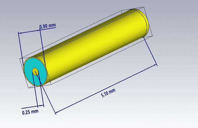

Hello,I have built a a resonator but I want to understand the physics behind it.
The mode is TEM ,Why when I make the resonator 1.5mm shorter I have the resonator frequency going up?
Why when I increase the permitivity of the dielectric inside I have the resonance frequency going down?
Why the permitivity changes the matching of the resonance?
Is there any mathematics that could exlaing why TEM mode acts this way?
Thanks.
If you make a structure smaller, the resonant wavelength will be smaller, so the frequency will be higher.
Your resonator is a short coaxial transmission line. The velocity factor on that line is proportional to 1/√(L⋅C), where L and C are the inductance and capacitance per unit length of line. Increasing permittivity Er, increases C, which reduces velocity, so the line is slower, and the resonant frequency is lower.
The characteristic impedance of a transmission line, is proportional to √(L/C). When you increase the permittivity Er, you increases C, so you lower the impedance of the line, which changes the impedance of the interface port.
At the same time, you are changing the velocity factor, so you are scaling the size in wavelengths and centre frequency of the resonator. Moving the centre frequency will change the Q and the matching at the original design frequency.
