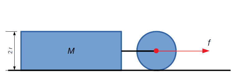

Imagine we have a cuboid of mass ##M## and height ##2 r## that slides without friction on a horizontal surface. It is accelerated by a line or rod that is connected to the axle of a wheel of mass ##m## (homogeneously distributed) and radius ##r##. A rope or something similar is also connected to the wheel axle and a constant force ##f## is applied through it perfectly parallel to the ground. The entire system accelerates as a result and at any given moment, its velocity is ##v##. See the figure below.
The kinetic energy of the system is $$E = \frac 1 2 M v^2 + \frac 1 2 m v^2 + \frac 1 2 (I + m r^2) \omega^2$$ where ##I = \frac 1 2 m r^2## is the moment of inertia of the wheel around its center and ##\omega## is its angular velocity; the extra term ##m r^2## comes from the parallel axis theorem since the wheel rotates around its lower perimeter and not its center. Now, since the wheel rolls without slipping, ##v = r \omega## and the kinetic energy reduces to a function of the single variable ##v## alone: $$E = \frac 1 2 (M + \frac 5 4 m) v^2$$
The person pulling the system performs work ##f d## where ##d = \int v \mathrm d t## is the total displacement. The power of this work, work per unit time, is hence ##f v## and all of this is converted into kinetic energy of the system, hence the equation $$\frac {\mathrm d E} {\mathrm d t} = (M + \frac 5 4 m) v a = f v$$ where ##a## is the linear acceleration. Assuming ##v \neq 0##, we may solve this equation for ##a## to obtain Newton's second law with an effective mass: $$a = \frac f {M + \frac 5 4 m}$$.

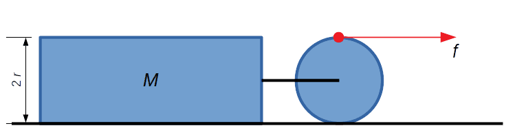

Now consider the case where the attached rope is connected not to the wheel axle but to a point on the wheel perimeter. At a given moment, the situation is as depicted below.
The work performed per unit time is now greater, since the top of the wheel is moving at a speed ##2 v##, meaning that the power produced is now ##2 f v##. Carrying out the same derivation as before, we obtain $$a = \frac {2 f} {M + \frac 5 4 m}$$ but this expression is independent of ##r##, so that in the limit ##r \to 0## we have two different expressions for the induced acceleration, even though the point of application of the force is the same in both cases!
Where lies the error?
The expression is indeed not a function of r, so the limit of any constant expression as some irrelevant variable approaches anything is still the constant expression. At r=0, you're attaching the string to the edge of a point, which makes no sense, but if you could wind an infinitely thin rope around a point, it would still give you twice the work for a given force relative to just attaching the string to the point and not winding it around.

Because you have twice the force. The force from you forward on the wheel plus the force of the ground forward on the wheel.
Two for one mechanical advantage still works, no matter how small the lever. But you do have to have the lever.

I can't see any paradox.
If the same magnitude of force is applied for both cases, the second arrangement is providing double power (energy by unit of time) into the system.
This seems to be the same case of pushing a disabled car on a horizontal road.
There are two practical ways to do it by hand:
1) You can push on the trunk, applying force F along distance d to produce work W in time t.
2) 1) You can push on the top of a tire, applying force F/2 along distance 2d (regarding your hands) to produce work W in time t.
No matter how small or big the diameter of the tire is, the magnitude of F in case 2 will always be half the magnitude of F in case 1.
As the work on the car in time t is the same in both cases, its covered distance, linear and rotational accelerations and final velocity will be exactly the same.

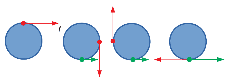

Here is what I have been told of the frictional force, when a torque with net linear force is applied to the wheel. The green arrow represents the frictional force.
Is this wrong?

It is incomplete. No load vector is depicted at the hub.
I am not certain whether a uniform free-floating disc is a shape that leaves its lower rim stationary when subjected to a tangential force on its top rim. No matter. A negligibly massive uniform disk with a load applied to its center does not leave its lower rim stationary when a tangential force is applied to its upper rim.

I am saying that the left-most force diagram is incomplete. You do not show the force from the big block that is being pulled by the wheel.
No, that's true. That's a force that is equal to Ma. Including this load will increase the frictional force in the forward direction, such that in the left-most diagram, the frictional force is ##f##?
The force that is equal to ##Ma## is nowhere depicted on any of the four pictures.
In the leftmost diagram and assuming that the wheel is of negligible mass compared to ##M##, yes, the rightward frictional force of floor on the wheel bottom is equal to the rightward applied force ##f## on the top of the wheel. The total of those two forces is approximately ##2f##
