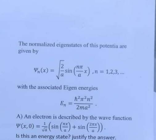

i have an exam in 2 days and in this question i don't know how should i proceed after that i simplified the wave function but i don't know how to confirm that it's an eigenfunction

Your attempt at a solution is not relevant to the question. To show that the given wavefunction is an eigenfunction, you need to operate on it with the Hamiltonian and see whether you get back the same wavefunction times a constant, in this case one of the energies ##E_n##.
