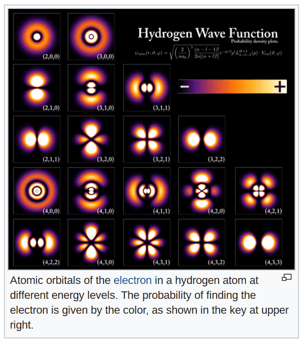

I'm trying to understand your objective. It sounds like you want to be able to generate figures like the following. Is that correct?https://en.wikipedia.org/wiki/Atomic_orbital
Well, sorta. I want to do this except I want to visualise the concept by "ghost" electrons appearing randomly in 3d space that the user can navigate around.
