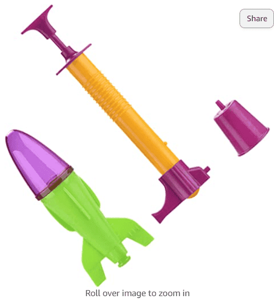

Water rocket toys are inexpensive. Buy one to experiment with and to learn from. What is the optimum ratio of air volume to water volume?
Likes DaveE, FactChecker, StellarisVoid and 1 other person

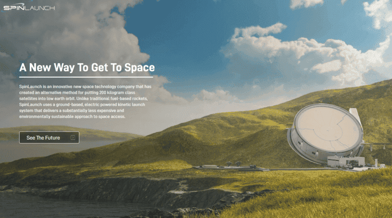

I am not sure.
I am in Year 8 so I do not know much about rockets and how the aerodynamics work(sadly) so I was hoping to find out some stuff here.
StellarisVoid said:
This is just a competition the physics department organised and not an official competition.
It's still important to understand the rules of the competition. For example, there are other ways to launch a rocket without propellant...
https://www.spinlaunch.com/#p1
Likes StellarisVoid
I don't think that there are any particular rules apart from not using solid fuel and not to make anything too complicated as well as making sure we won't set the field on fire. Basic safety rules only seem to apply but I will check tomorrow.
Thanks for the link! I'll have a look at it.

The way to find that out is to try it. In other words experment using the toy rocket.
There are also many Youtube videos of larger water rockets. You can learn from them.
It is hard for us to believe that there are not written instructions and rules for this competition.
