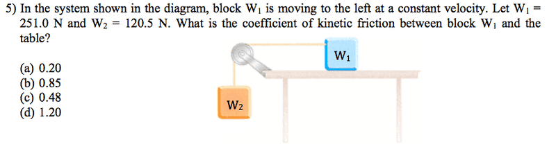

Ok so I tried making myself a free-body diagram but I reached a dead end..
Step 1) fkinetic = μkn
fkinetic = μk(251)
fkinetic / 251 = μk
Step 2)
Fx:
T1
Fy
n = (m)(g) = 251 N
120.5 N
Step 3)
ƩFx = m(-a) since it's moving the left or ƩFx = 0 (since it's moving at CONSTANT velocity)
ƩFy = ma
Step 4)
ƩFy: 251 + 120.5 = (25.58 + 12.28)a
*** I got the masses by solving 120.5 = m(9.81) and 251 = m(9.81) ***
ƩFy: 371.5 = (37.86)a
ƩFy: 371.5/37.86 = a
ƩFy: 9.81 = aStep 5)
T1 = m(-a)
T1 = (25.58)(-9.81) = 250.9 = 251 :(
Help?
One thing I would advise you to do is not to substitute the numbers in until the end - it's better to work with symbols as long as possible.
Using your free-body diagrams, write out equations for the horizontal and vertical forces acting on W1 and the vertical forces acting on W2.
Then see how you can combine them to get a simple expression for μ

ƩF = ma. In this case, you're told that a=0, and this applies to both masses.
Also, you need to remember the direction of the forces.
So,
ƩFx = T1 - fk = 0
→ T1 = fk

Your first equation is ok.
Apply the same reasoning to the second equation:
ƩFy = T2 - W2 = 0
→ T2 = W2
Now, T1 = T2 since the pulley just changes the direction of the tension force and not its value.
So, you can combine the 2 equations to eliminate the tension force - the answer should be clear after doing that.

T1 = T2
T1 = 120.5
So for
T1 = 251μk
120.5 = 251μk
0.48 = μk
Thanks!
One quick question though...
Whenever I see a problem like this - two blocks and a pulley...
T1 always equals T2?
As long as the rope and pulley are 'ideal', ie don't have any mass, then the 2 tensions will be the same.
