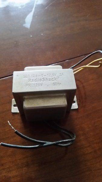

Fair enough. since this project involves connecting to the AC Mains, can you say a bit about any experience you have with AC Mains projects? There are several very important things to get right to keep the possibilities of electrocution and fire down as low a possible. We've mentioned/alluded to a couple of them so far, and based on your answer to my query we may need to expand on them quite a bit.
For example, Dave says that a 3-prong power plug is shown in the video. Do you know what you need to do with that 3rd prong (Earth ground) connection right away as the wire enters your enclosure? Are you planning on using a metal or plastic enclosure for this project? Can you Upload the datasheet for that input AC Mains transformer please? Is it singly-insulated or doubly-insulated? (if you don't know, we will be able to tell from the datasheet.

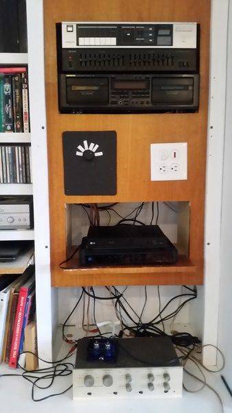

Berkeman: My intent is to cut a piece of metal to cover the space left when Dish supplied much smaller components. I would then attach the ground wire from the outlet to the metal plate. I would use 2 potentiometers to simulate a balance. I would then rely on the metal plate to conduct ground. As a Virginia Class A Contractor I am licensed for almost any construction project. In that capacity I do wire my own residential construction. It is always inspected by the local electrical inspector because a second set of eyes is a good idea. That is what I am depending on you for. As for the enclosure, I didn't really consider enclosing it. It will be inside the "cabinet" and not accessible.
As to the transformer I have supplied a picture of it. I looked thru the internet and was unable to answer your questions. This is probably a good time to mention that I considered mounting the transformer remotely - that is located somewhere else in the cabinet and running it's output to the "board." From my perspective that would get a heavy item attached some where else and making removal of the project easier.
