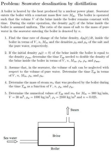

Help with transient mass balance for desalination by destillation
The discussion centers on solving a transient mass balance equation for desalination through distillation. The key equation presented is d[rhob*V]/dt = Min - rhob*Min*(1-n)/(rhos + rhow), where rhob represents the density of the fluid, V is the volume, Min is the mass inflow rate, n is a variable related to the process, and rhos and rhow are densities of the solid and water, respectively. Participants seek clarification on deriving the term rhob*Min*(1-n)/(rhos + rhow) within the context of ordinary mass balance principles.

So far I have gotten:
d[rhob*V]/dt = Min - ?
is what i got
Mind me asking how you got the out term (the rhob*Min*(1-n)/(rhos + rhow))? Not saying that you are wrong but having trouble getting this and curious how you got to that.
