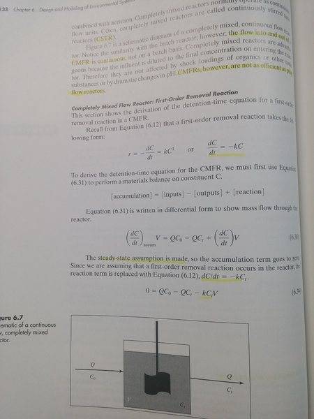

@Chestermiller, that's so weird, in my textbook, they say they are equal and transition from dc/dt to kC
This is why, in my first post, I said that it is "just plain stupid." The author of your textbook (and many others in their textbooks) has done you a disservice by writing the equation in this way and confusing you. Unfortunately, this is not the only thing in textbooks that confuse students. Have you had a course in thermodynamics yet? Thermodynamics texts are chock full of confusing and incorrect statements.

Oh wow, I've been cheated :(. No , I will have not and am not required to take any thermodynamics courses (Civil Engineering Student). My original question arose from a Waste Water Process Engineering course I am currently taking.
Can you please recommend a reference that I can read to help learn about more this?

I like Chemical Reaction Engineering by Octave Levenspiel. This book is available as a pdf on line. However, even Levenspiel makes this same boo boo with the time derivative. In his defense, he no longer continues to do this when he gets to sections of the book where he describes how to analyze CSTRs and plug flow reactors.
