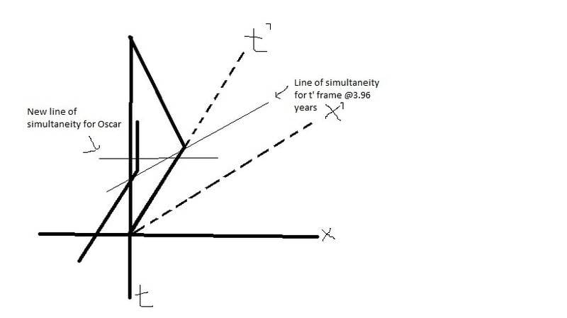

I was hoping I could get some help on wrapping my head around the twin paradox. The problem is I have never seen the following "contradiction" addressed. I understand (at least on paper) that events simultaneous in one frame needn't be simultaneous in another. But consider the following argument:
Consider three observers, Oscar, Beth, and Jim.
Jim is tasked with retrieving a rare mineral from the planet near the star Alkaid. Alkaid is 99-light years from Earth. Jim knows that with the technology available he can travel at a speed of .98c. The trip to Alkaid will therefore take him 20 years in his frame. However, to observers on Earth, it will take 101 years.
Beth stays at home on the Earth. Jim travels to Alkaid. Oscar is in the same reference frame as Jim. Jim gets in a rocket and travels to Alkaid. The Earth and Alkaid synchronize clocks with respect to one another. Jim gets in a rocket and travels to Alkaid. When he leaves his frame, his clock, Earth’s clock, and Alkaid’s clock all read 0.
When Jim arrives at Alkaid he finds that the clock on Alkaid which was synchronized to Earth reads 101 years. Oscar however, who was in the same frame as Jim, is present whizzing over Earth at the time Jim reaches Alkaid. He looks down at the clock on Earth and it reads 3.96 years! This is because the Earth bound clock was moving relative to their frame.
Imagine Beth, when her clocks reads year 3.96, looks upward. She sees Oscar whizzing by over her, and sees that his clock reads a time of twenty years. She reasons that this means Jim has already reached Alkaid. She is able to send a message to Oscar (because Oscar is right above her) to reverse the direction of the ship. Oscar does this nearly instantaneously. Jim returns home another 3.96 years later. This means that he returned home to Earth in 7.92 years (as measured by the clocks on earth), with the rare mineral intact.
But to observers on Earth this trip should have taken a total of 202 years.

Why do you think it is not consistent? Jim will never arrive if Beth orders him to turn around at the time (in her frame) of 3.98 years. If Jim was allowed 20 years in his traveling frame he would arrive, ergo he must have turned around earlier than when the time in his traveling frame reaches 20 years, which happens to be the time when Oscar arrives at Earth in that frame.

But you again fail to take the simultaneity of relativity into account! If Jim is ordered to stop when the clocks in Beth's frame shows 3.98 years, Oscar will know that this is not simultaneous (in his frame) to when he finds himself at an event where the clock in Beth's frame shows 3.98 years.

You're trying to work through how Oscar can say that Jim has already landed on Alkaid, and then after he slows down to match Beth's speed say that Jim has not yet landed on Alkaid.
First we have to consider exactly what it means when Oscar says that Jim has "already landed" on Alkaid which is 3.96 light-years away. It means that the light from Jim's landing (or a radio message from Jim confirming his arrival) will reach him in less than 3.96 years from now. This is just the basic idea that when light from some event hits my eyes, I can figure out when the event happened by subtracting the light travel time from the time that the light hit my eyes. Note that because the light or radio message from Jim's arrival has not reached Oscar yet, he has not actually observed that Jim has landed; he has merely calculated from what he knows of the speeds and distances that the light from Jim's arrival 3.96 light-years away will reach his eyes in less than 3.96 years.
But when Oscar slows down to match speeds with Beth, he must redo the calculation. This time he calculates that Alkaid is 99 light-years away and that it will be more than 99 years before the light from Jim's arrival reaches his eyes. Therefore, Jim has not yet arrived. Again, this is not something that Oscar observes, it's something that he calculates.
Thus, the answer to your question is that nothing has happened to Jim, and the only thing that has happened to Oscar is that he has changed speed and position in such a way that the light from Jim's arrival will reach his eyes at a different time.

The problem here is with the notion that Oscar "changed frames". He didn't. A frame no more than a convention for assigning x, y, z, and t coordinates to events so Oscar is always in both frames. When he slowed down to match speed with Beth, his speed in one frame (the one in which Jim's speed is 0) changed from 0 to -.99c while his speed in another frame (the one in which Beth's speed is 0) changed from .99c to 0.

Drawing a spacetime diagram (with simultaneity lines) helped me understand the situation more clearly.
aliens123 said:
I understand this, but this seems to imply that the things didn't really happen simultaneously, only that it would be calculated this way. But special relativity tells us that things really are simultaneous in a different frame.
But this is the entire point. There is no such thing as "really simultaneous" which is frame independent. It therefore makes no sense to claim that two events are simultaneous without referring to which frame they are simultaneous in.

For those of you still interested in this thread, here is where I am at so far.
Ignore the OP's original arguments. I don't see how you can escape the following conclusion:
To Oscar, the event of Jim landing on Alkaid had already happened (in his first frame) but upon switching frames hasn't happened yet.
Now the above statement technically isn't a contradiction, so right now I'm rolling with the thought that I do understand this; special relativity just has some very counter-intuitive notions of what it means for something to "happen." (The concept of a privileged past, present, and future, has to go).
I made a magnificently drawn picture on MS paint;
And thanks to everyone taking the time to reply to this thread. I'm not trying to "disprove" special relativity or anything, I'm just trying to come to an understanding of it.
Not quite that dire... It's more that in classical mechanics there are two possible relationships between any pair of events: Either A happened before B or B happened before A. Either way, one event is unambiguously in the future and the other in the past, and all observers will agree about this. Relativity keeps both of these possibilities and adds a third: some pairs of events cannot be ordered that way. It will always be the case that the relative order of these events could never have been directly observed, only inferred; and that what happens at one of these events can never influence what happens at the other.
If you google for "past light cone", "future light cone", and "spacetime interval" you'll find much more on the topic.

aliens123 said:
special relativity tells us that things really are simultaneous in a different frame. "
No. SR tells us that "simultaneous" is a convention, not something "real".
It's easy to escape this conclusion: just say that the only events that have happened, from anyone's point of view, are the events in their past light cone. When Oscar passes Earth, the event of Jim landing on Alkaid is not in his past light cone, so according to this definition, it hasn't happened. The fact that, according to Oscar's simultaneity convention, the event of Jim landing on Alkaid is simultaneous with the event of Oscar passing Earth, is irrelevant, because simultaneity, as above, is just a convention, not something "real".
It is only counterintuitive in that we have to give up simultaneity as our criterion for what has happened. But, as above, SR has a perfectly good criterion (what has happened for you is what is in your past light cone) to put in its place.
