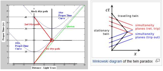

I don't know if you are comfortable with space-time diagrams. If so, you can put the problem in the context of comparing paths traveled through 4-dimensional space. Here are a couple of sketches that tell the story. I've set this example up for a 10yr trip out and 10yr trip back. You can essentially disregard the effect of the acceleration, other than the fact that it puts the traveler on a different path (associated with change of velocity).
Basically, the traveling twin is taking a shorter path from the starting point to the ending point. It may look like the traveling twin takes a longer path, because the lines are longer on the computer screen. But, look carefully and you will see hyperbolic calibration curves that calibrate the screen distances properly for the Minkowski space.
Unfortunately I am having trouble with that graph.
I'm just trying to understand why 2 years only passes for him and 3.33 years passes for the clock on Earth. I want to understand this without just saying it's because of some equation which I may not even understand.
Ohh those graphs are dandy for a non mathimatical approach. Maybe look into a right angle triangle, pathagoreons theorem and c. From there it translates well into those spacetime diagrams. Well at least the less decorated ones, unlike those above :smile:
To understand "why" it's 3.33 years for Earth clock and 2 years for the ship look into intervals.
it brings a time component into distances.
The interval between the ship starting its journey to the clock "handoff" (return trip) is the same for both the Earth FoR and ship FoR. However the time taken to travel this distance and the distance traveled are both calculated to be different values then what the other FoR calculates.
I hope someone here with the skills can let you know what figure each FoR comes up with for distance travelled. Seems like it is important in answering the question how a different amount time passed for each FoR. (the ship claims it traveled less distance then what Earth FoR claims, this is the exact same relationship as the different amounts of time passed issue)

Let's consider some specific numbers. c=1 (choice of units). v=0.8. This implies [itex]\gamma=1/\sqrt{1-v^2}=1/0.6=5/3\approx 1.667[/itex], and [itex]1/\gamma=3/5=0.6[/itex]. Let's say that the ship is gone for 20 years in Earth's frame. Then the journey will take 20*0.6=12 years according to clocks and people on the ship. In the ship's frame, Earth's clock is slow by a factor of 0.6, so just before the turnaround, it's only at 6*0.6=3.6 years. Similarly, on the way home the time it displays will only increase by 3.6 years. But at the turnaround event, the number it displays will change from 3.6 to 16.4 in no more time than it takes to turn the ship around. If we idealize the scenario by taking the turnaround to be instantaneous, then the clock and everything on Earth instantly ages 12.8 years.
Fredrik said:
...But at the turnaround event, the number it displays will change from 3.6 to 16.4 in no more time than it takes to turn the ship around. If we idealize the scenario by taking the turnaround to be instantaneous, then the clock and everything on Earth instantly ages 12.8 years.
Nicely stated Fredrik. Several times I have posted statements to the effect that the astronaut must consider the Earth clock to be running faster than his own while accelerating thru the turnaround. All I got was negative comments.

And there has been no jumping of the time on the Earth clock as experienced by the traveling clock at the point of turn around.
But I would like to emphasize that the frame invariant way to look at the Twin Paradox is to use just one FoR for the entire scenario. Any one will do.
Snip3r said:
Aren't the two situations identical and why the ship's clock doesn't fast forward to 16.4 wrt earth?
Didn't I answer the first half of that here? (Post #2, answer b).
The reason why the ship's clock doesn't jump ahead in Earth's frame can be seen in the spacetime diagram on the right in bobc2's post #6. By definition of "comoving inertial coordinate system", the simultaneity lines are orthogonal to the tangent of the world line. That means that (a) all the simultaneity lines in Earth's coordinate system are horizontal in the diagram, and (b) that before the turnaround, the ship's experiences are defined as the coordinate assignments made by a coordinate system with the blue lines as its simultaneity lines, and after the turnaround, it's defined as the coordinate assignments made by a coordinate system with the red lines as its simultaneity lines.
Part (a) is the reason why the ship's clock doesn't jump ahead in Earth's coordinate system. Part (b) is the reason why Earth's clock jumps ahead in the ship's coordinate system.

Yes, I was confused by the "paradoxes" at first. The first one I really tried to understand was the pole and barn (a.k.a. car and garage) paradox. It took me several days to understand it. I didn't learn about spacetime diagrams until later. Once I did, these paradoxes all became trivial.
Learning to draw spacetime diagrams is definitely the way to go. The main idea can be understood in minutes. Once you understand them, solving SR problems qualitatively is just a matter of drawing straight lines on a piece of paper.
Snip3r said:
[..] There is no consensus among people who profess an explanation not to mention those who say acceleration is the culprit in twin paradox...
The change of velocity is necessary to create the asymmetry that Langevin was looking for, and as commonly a change of velocity implies acceleration, he gave an example with acceleration - but acceleration isn't the essential feature.
The same can also be achieved in the following variant without acceleration: instead of a clock or person that turns around, there are two space ships, a first one that leaves the Earth and a second one that is going to the earth. They pass each other far away from Earth and when they pass, the clock of the second spaceship is set to the time of the clock of the first one. The result is practically the same of course, as it's all a straightforward application of the Lorentz transformations.
