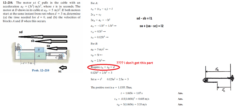

Attached my constraint equations
How is sa + sb = d at any stage of motion (circled in the attachment)?

Pretend just block A moves (B is at rest). Then isn't it obvious A has to move d=3 meters? So sa = d, sb = 0.
Pretend only block B moves. Isn't it obvious block B has to move 3m since A is stationary and d is the distance from the left side of A to the left side of B. So sb = 3 and sa = 0.
So by superposition, if they can both move, sa + sb = d.
Thank you, it makes sense that A and B together must travel a distance of 3m so that the right end of B is at the left end of A. However isn't sb+sa misleading as they're measured from the datum? It should be deltaSa + deltaSb = d ?
Very good point! But it looks like in the text on the right they decided to make sa and sb both positive by definition, which as you point out is not what the arrows on the diagram on the left define. So, good point but their method still gives the right answer.
In other words, sb should be negative going by the picture arrows but then superposition is sa + (- sb) = sa - sb. Amounts to same thing.
I think they mean dsa and dsb but when you integrate from zero to dsa or zero to dsb, they become sa and sb anyway as it's sa-0, sb-0. Either way it makes sense, thanks for your help
