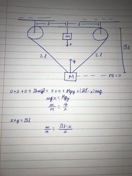

Can you please confirm if what I have done is correct? After this, I aim at writing x and l individually in terms of l via trigonometry, however, I am not able to establish the relation between angles that the string will make with each other.
I have attached an image, please check it.
Any ideas on how we can relate x and y to l individually? The relation: x+y= 3½ is a relation having both x and y.
You are starting to get the idea, but it stil needs some additional computing. What is the height of the two as they meet? I get that the mass ## m ## drops by a distance of ## \frac{\sqrt{5}}{2} L ##. (Compute the y distance when the hypotenuse is ## \frac{3}{2} L ## ).## \\ ## Then you also need to compute how much mass ## M ## rises, etc. That is actually straightforward. It starts out down below by ## \sqrt{3} L ##.
How did the mass m drop by √5/2? Moreover, if it did, then we can say that since x+y=√3l, y=√3l-√5/2
See my post 6 above. Hypotenuse=(3/2) L.
Oh ok, I will try using it.
