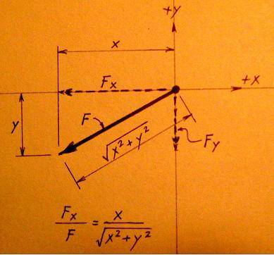

You have all the X and Y components of each vector. Are you sure you need the individual angles?
Good point. It's usually easier in this situation to take advantage of the fact that corresponding sides of similar triangles are all in the same proportion.
The vectors' lines of action are defined by Cartesian coordinates (you can think of the x and y dimensions as position vectors). So by similar triangles we know the magnitude of the x component of the vector divided by the magnitude of the vector equals the x dimension divided by the distance from the origin to the vector's head.
so by doing that for each force vector, I'll be able to get the value for the resultant?
Yes indeed. Just add the x force components together, and then the y force components together, as if they were scalars. Those algebraic sums will equal the x and y components of the resultant. Keep in mind the left and down directional senses are assigned a negative sign.
