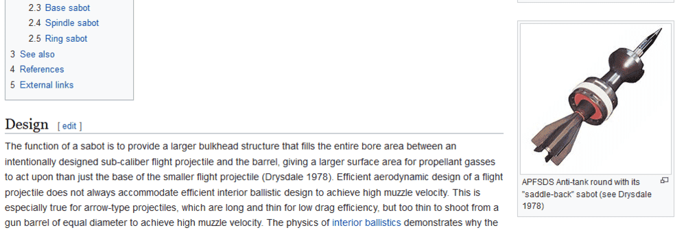

Finally, what other rules are there for this project? For example, do you know what a sabot is, and how the use of one might improve the accuracy of your ping ball launcher dramatically? :smile:

Anything that would impart a spin would need to be accounted for. A sabot that @berkeman mentioned probably helps reduce any spin. You imply that it would have a primarily horizontal barrel. To minimize spin and friction, you might consider resting the ball on a net and making a paddle hit it from below with a precise velocity. A "lob" in a high trajectory might actually be more accurate than what you have described.

Whoops, I meant for the sabot to perform a different function, but you are right, it looks like it's mostly a propellant-to-projectile force coupling enhancer.
But the image at Wikipedia about sabots helps to remind me how they increase the accuracy and efficiency of some rounds. To the OP -- this is why we need more information about the project rules -- can you attach anything to the pingpong balls to improve the accuracy? :smile:

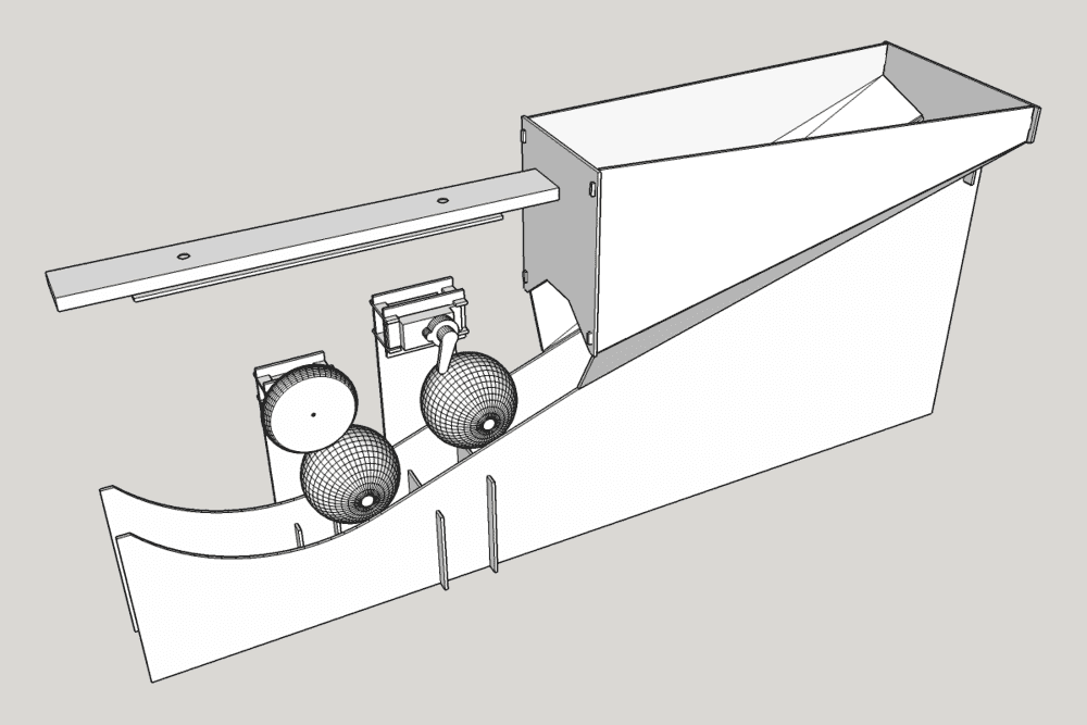

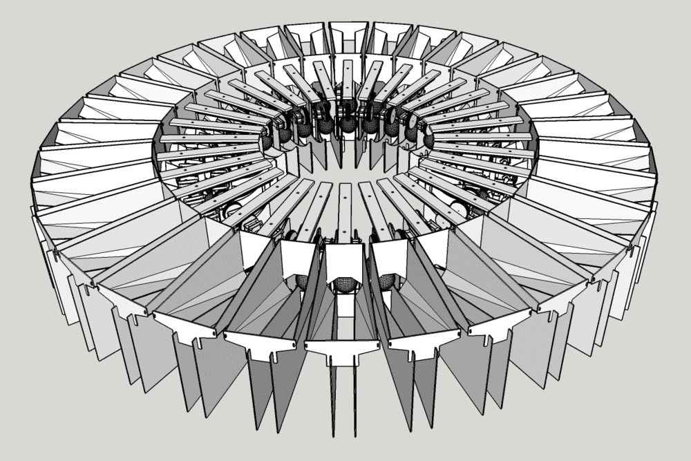

Thanks for the quick reply. Yes this is regarding the same project I asked about before; at that time I was just brainstorming, and unfortunately since then, with school- and work-related responsibilities, I haven't progressed much beyond the drawing board aside from a simple prototype I cobbled together earlier this year (I may even have lost that with my recent move). I constructed it as I had last described it in that thread, though not 3D-printed as I had originally wanted due to cost if I were to scale up to my end goal.
As for the description of my project that you requested, I think that's fair enough. My original hope was to re-create this CGI concept:
I have a general idea for how I would want to structure everything (attached pic - full; the attached pic - single, basically shows how I failed to stabilize the motor/wheel above the ramp), and I think I'd be able to use an arduino microcontroller to make it work, but I feel like that one issue that will sink this project is the feasibility of the accuracy and precision that's needed.

Hitting a fixed 0.5 cm radius target about 30 cm away with a 4 cm diameter ball does not seem to require accuracy or precision. Atan(2.5/30) ≈ 4.75 degrees.
@anorlunda I hadn't considered wooden balls before, but I can definitely see how that may work out in terms of bounce and sound. I'll definitely look into that. Thanks for the suggestion!
@Baluncore In that case, the problem I've been having must be largely due to the variable degree of spin that the ball is picking up on launch. Perhaps if wooden balls will work for bounce and sound, then they may also solve my trajectory problem too. Thanks!
