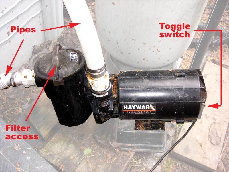

I need some help. Attached is a pic of my standard 1/4hp Hayward pool pump. I want to enclose it to make it quieter. (The sound is being transmitted by air rather than by physical contact.)
As a "proof of concept" I stuffed it in a storage bin packed with a couch cushion, and it was a great improvement, so I know it is possible. Of course the couch cushion will not work in the long run because of heat buildup.
I'd like a more viable solution, one that doesn't cost too much but addresses the issues:
- noise silencing
- cooling
- vibrational damping in the base
- drainage (pump will spill lots of water when being primed etc. can't have it filling up with water)
- easy access to filter lid
- easy access to on/off toggle
- two pipes exit the container
What cooling is good/easy? A fan, blowing air? Coils, circulating pool water?
If air, how will I allow circulation of air without cutting holes in the container that will vent sound?
Help?

It looks as if you should be able to drill a few holes in that base plate (if they aren't already there; it's hard to tell). I'd start by bolting, clamping or screwing it to the top of a rubber block or large coil spring. Even though the sound is propagating through the air primarily, that plate vibrating against the ground probably causes a lot of it. I'd put some similar sort of support under the filter canister to even out the gravity load and further dampen vibrations.
For an enclosure, I think that a simple plywood box lined with some sort of foam insulation should be plenty. You can cut hinged access panels wherever you want. Since you'll need a cooling system anyhow, that shouldn't cause a problem.
While any kind of forced air would be helpful, I think that you hit on a really good idea about circulating the water. Divert your incoming supply through a few turns of copper or aluminum tubing coiled around the pump before it enters. Maybe some heat-sink compound would be helpful in that application. The conductance of the tubing should transfer a fair bit of heat to the water, which will carry it off to the pool and make room for more cold water. Since you only need the cooling while the pump is running, it'll be self-regulating. Just to be safe, put a thermal cut-off switch in the power line. That would also protect the pump if it happened to run dry (if sensitive enough).

The hilit/muted portions of the pic differenitate between the actual pump itself and the base it attaches to (with 4 bolts). The base is simply crummy plastic, designed to hold it to the filter cannister behind. It serves very little use.

The pump is sitting on 2x6s, which are on a ½”x2’x2’ rubber mat, which is, in turn on a 2” thick concrete tile.
The noise is high-pitched and “breathy”, rather than thrumming or vibrating. And it virtually disappears whenever I get the pump serviced and lubed (shop job, not user-serviceable).

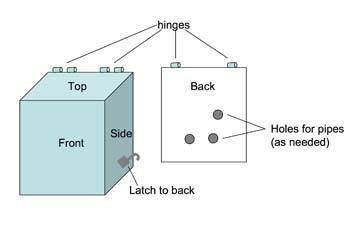

Are you just interested in muffling the sound somewhat? Completely blocking all sound might not be very feasible, but to muffle it, why not just build a plywood box? On the side with all the pipes, just cut holes large enough for the pipes to fit through and leave that side permanently in place as the back of the box. Then, construct the remaining sides attached to the top, and use hinges to attach the top to the back. A couple of latches near the bottom to connect the two sides to the back will make it easy to open and close by lifting the entire box up by the hinge. Paint the plywood with several coats of a good outdoor paint, and if needed, add some foam insulation along the interior of the box.
If you're worried about the motor overheating, you can put a vent on the side of the box nearest to the motor, but that'll of course reduce the amount of sound blocked.
Edit: I've attached a figure to give you a rough idea what I mean, though I think it's a simple enough concept you probably don't need it (I always prefer pictures for clarity).
  • Diagram of a box enclosure in two parts: a front, top and side panel on the left, and a back panel on the right, with hinges along the top edge, a latch on the side to the back, and two holes for pipes.

I appreciate the input, but if you follow the thread you'll find that
1] cooling is my major concern. A hole in the side of the box won't be enough. And yes, it would drastically reduce the sound dampening.
2] I do not have a choice where the pipes exit. One of them goes straight up.

I have decided that a heat exchanger system would result in too much flow loss due to friction to make it practical. While it might heat the water, problems with throughput (important to keep the pool clean) could leave me worse off than before. I may do it someday, not not just yet.
So -
I have enclosed the pump in a rubbermaid tub, lined with foam, and supported on rubber and wood pilings. The foam-lined lid has resulted in a promising drop in the higher-pitched noises.
There's an ironic twist to the story. Once I had put all the plumbing back together and was cleaning up, I noticed the filter making a surprising amount of noise, as were other parts. I worried that perhaps I had jigged something, and was now getting unwanted side-effect noises due to the new construction.
After some checking and testing, I concluded that these were not new noises at all; they had been there all along but I had not noticed, as they were masked by the loud pump. Overall, it's quieter.
