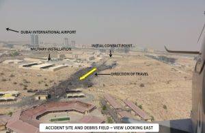

https://gigaom.com/2011/04/04/lithium-ion-batteries-faulted-for-jet-crash/
A http://www.gcaa.gov.ae/en/ePublication/admin/iradmin/Lists/Incidents%20Investigation%20Reports/Attachments/16/2010-GCAA%20Accident%20Preliminary%20Report%20B747%20DXB%20.pdf on the fatal crash of a UPS jet carrying a large shipment of rechargeable lithium batteries suggests that safety issues still remain for transporting these flammable devices, which are used to store energy not only for mobile phones and laptops but also a growing fleet of plug-in vehicles.
The crash, which killed both pilots, occurred near Dubai on September 3, 2010.
