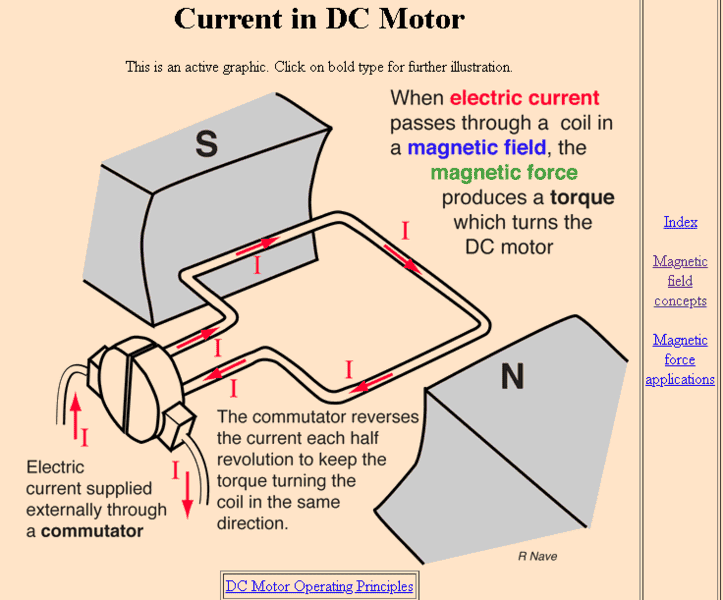

Bottom line is you can't make a coil in a field rotate more than a half turn without reversing current, which we call commutation.
You've already named the three ways to achieve that.
from http://hyperphysics.phy-astr.gsu.edu/hbase/magnetic/motdc.html

Samson4 said:
... a dc motor that doesn't use pwm, commutators...
I'm not sure what you mean here? No brushes makes sense, but what have you got against commutation? Is electrical commutation acceptable?
If so, how do you define PWM, since electrical commutation requires switching current to coils very similar to PWM?
Since you've seen brushless DC motors, what is it about them that doesn't meet your requirements?
