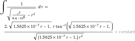

well seperating them it is dr/((r^3/R)-r^2)^1/2)=dtheta
i used wolframalpha and got:
what is attached and I used R= to 6.4E6m (radius of the earth)
  • Integral of 1 over the square root of (r^3/(6.4 x 10^6) minus r^2), with respect to r, equal to 2 sqrt(1.5625 x 10^-7 r - 1) times r arctan of sqrt(1.5625 x 10^-7 r - 1), divided by sqrt((1.5625 x 10^-7 r - 1) r^2), plus constant.

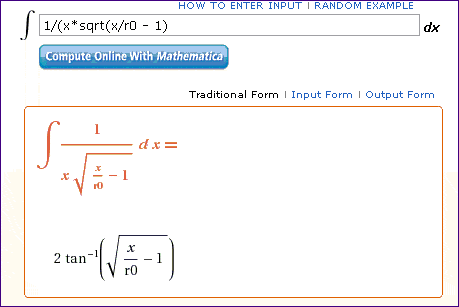

If you keep things in symbolic form a little longer, some good things might happen :smile:
Attached is a snapshot of a Wolfram Integrator output where for the function I've pulled an r2 out of the radical before letting the integrator loose.
Thus you have:
[tex]\theta = 2 tan^{-1} \left( \sqrt{\frac{r}{r_o} - 1}\right)[/tex]
which can be readily solved for r. Keep in mind the trig identity for tan(θ/2) :wink:
  • Screenshot of Wolfram Mathematica integrator input and output: integral of 1/(x*sqrt(x/r0 - 1)) dx, with the result 2 tan^(-1)(sqrt(x/r0 - 1)).
