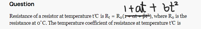

Differential form of ##R(t)=R_{0}(1+\alpha(t-t_{0})##
none
I wanted to find the differential form of the above equation and i get $$\frac{dR(t)}{dt}=R_{0}\alpha$$ (##t_{0}##=0 degree celsius)
So $$\alpha=\frac{dR(t)}{dt} \frac{1}{R_{0}}$$ (##\alpha##= temperature coefficient of resistance ##R_{0}##=Resistance at temperature 0 degree celsius)
This idea arises from a question
Here if i use this differential formula i derived i get $$\frac{dR(t)}{dt}\frac{1}{R_{0}}=a+2bt$$ which should be the value of ##\alpha## ?
But that doesnt give me the correct answer, i would get the correct answer if $$\frac{dR(t)}{dt}\frac{1}{R(t)}=\frac{a+2bt}{1+at+bt^2}$$
I dont get why the denominator changes to ##R(t)##
The differential form that you are seeking is $$\frac{dR(t)}{dt}=\alpha ~R(t).$$Find the solution and then note that the expression ##R(t)=R_{0}[1+\alpha(t-t_{0})]## shows the first two terms of the series expansion of the solution about ##t_0##. If you add one more term to the series, you get the quadratic term.

Write this a little more explicitly. If ##\alpha(t_0)## denotes the temperature coefficient at temperature ##t_0##, then $$\alpha(t_0)= \frac{dR(t)}{dt}\bigg{\rvert}_{t=t_0} \cdot \frac 1 {R(t_0)}$$ If you want the temperature coefficient ##\alpha(t_1)## at some other temperature ##t_1##, $$\alpha(t_1) = \frac{dR(t)}{dt}\bigg{\rvert}_{t=t_1} \cdot \frac 1 {R(t_1)}$$ Since ##t_1## could be any temperature, you can drop the subscript and write $$\alpha(t) = \frac{dR}{dt}\bigg{\rvert}_t \cdot \frac 1 {R(t)}$$ Apply this to the question that you quoted in the OP.

With this equation ##R(t)=R_{0}[1+\alpha(t-t_{0})]## when we say at temperature t1, we mean ##R(t1)=R_{0}[1+\alpha(t1-t_{0})]## ?? Accordingly it follows ##\alpha=\frac{dR(t)}{dt} \frac{1}{R_{0}}## isnt ##R_{0}## acting as a constant here??
The question you quoted in the OP asks you to find the temperature coefficient ##\alpha## as a function of temperature: ##\alpha(t)##.
The coefficient at temperature ##t_1##, ##\alpha(t_1)##, is used to calculate the resistance at temperatures "near" ##t_1## to a good approximation: $$R(t) \approx R(t_1)\left[1+\alpha(t_1)(t - t_1)\right].$$ Here, ##R(t_1)## is the resistance at temperature ##t_1## as you can see by letting ##t = t_1## in the above formula. The closer ##t## is to ##t_1##, the better the approximation.
If you solve the formula for ##\alpha(t_1)##, you get $$\alpha(t_1) \approx \frac{R(t) - R(t_1)}{t - t_1} \cdot \frac1 {R(t_1)}.$$ In the limit of letting ##t \rightarrow t_1##, the fraction becomes a derivative and the expression is exact: $$\alpha(t_1)= R'(t_1) \cdot \frac1 {R(t_1)} = \frac{R'(t_1)}{R(t_1)}.$$ You can take this equation to be the definition of ##\alpha(t_1)##.
In the question in the OP, they give you an example where the resistance varies with temperature as $$R(t) = R_0(1 + at + bt^2).$$ For this example, what do you get for ##\alpha(t_1)## if you use ##\alpha(t_1)= \dfrac{R'(t_1)}{R(t_1)}##?

This made it all click. Thankyou so much.

$$\frac{a+2bt_{1}}{1+at_{1}+bt_{1}^2}$$

Yes.
