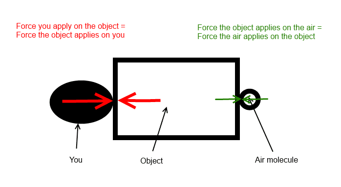

Perhaps see this diagram..
The red forces are equal (Newtons 3rd law)
The green forces are equal (Newtons 3rd law)
The red forces are not always the same as the green forces.
Kaneki123 said:
Thanks for the answer...You said 'at some point the air molecules cannot provide an equal force'...Can you kindly state the reason as to why the air molecules would not be able to react with equal or same force?
I only was responding to your example where you said the air molecules were applying the same force to the object as you were. As we are stating, this is not always the case, certainly it is not demanded by the 3rd law. So in general it is not true.
CWatters said:
No.
The force you apply to an object is not always the same as the force the air molecules apply back on the object.
The force you apply to an object is not always the same as the force object applies to the air molecules.

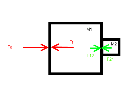

Air is complicated because it comprises billions of individual molecules. To simplify the question consider a force Fa applied to two objects M1 and M2 that are touching each other as shown.
Newtons second law says that
Fa = (M1+M2) * a ..........(1)
where "a" is the acceleration of both. They both accelerate at the same rate because M1 is pushing M2 to the right.
So your question is about the green forces and why they don't equal the red forces.
F12 is the force M1 applies to M2
F21 is the force M2 applies to M1
Mass M2 is accelerating at "a" so the force F12 must be given by Newtons second law..
F12 = M2 * a ...........(2)
So comparing (1) and (2) you can see that the green force F12 is not equal to the red force Fa
For completeness..
The force F21 is given by Newtons third law so
F21 = F12
Once you understand CWatter's example, then consider this:
Take M1 alone and divide it into n thin sheets each with a mass of M1/n.
You are accelerating M1 with a force of Fa pushing on sheet 1 which is equal to M1 x a
Where M1 can also be expressed as the sum of all n of the sheets (n x M1/n)
Sheet 1 pushes on a mass equal to a mass equal to M1 minus the mass of sheet 1 or M1-M1/n, which is also being accelerated at a, so the force between sheet 1 and sheet 2 is (M1-M1/n) x a
Sheet 2 pushes on sheet 3 with a force of (M1-2M1/n) x a
Sheet 3 pushes on sheet 4 with a force of (M1-3M1/n) x a
Sheet n-1 pushes on sheet n with a force of( M1-(n-1)M1/n) x a = M1/n x a.
As you divide M1 into more sheets (n increases), the mass of each sheet (M1/n) decreases and the force between the last and second to last sheet decreases. As n approaches infinity, the force between the last two sheet approaches 0.
