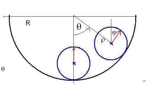

Suppose we have a skateboard half-pipe. The half-pipe has a radius R. We take a bicycle wheel of radius ρ and let it roll into the half-pipe. The wheel rolls without slipping ( and doesn't fall over, of course). Let Θ be the angle from the vertical to the line connecting the center of the half-pipe to the center of the bicycle wheel, and ø the angle the bicycle wheel has rotated.
(a) how are Θ,ø, R and ρ connected if the wheel rotates without slipping?
(b) Find the Lagrangian for the bicycle wheel. Use your answer from the previous part to simplify the Lagrangian.

I am very familiar with how to evaluate and set up lagrangians. However i am having trouble figuring out how to relate the variables for part a. I know the potential will be in the form of U=mgh and how to take partials to get the equations of motion.
It may be that i am confused about the angle Θ and where it is defined. something just isn't clicking. Any point in the right direction would be greatly appreciated. mostly i just need another mind to help me decipher how to do this. Once i get the relationships i should be good to continue on.

Hi Eric, welcome to PF!
Imagine that a line is painted across the wheel, and it is vertical when the wheel is at the bottom of the tube. φ is the angle that line encloses with the vertical as shown in the figure, and θ is the angle showing the position of the centre of the wheel with respect to the vertical.
The wheel spins around its axis, and the centre of the wheel moves along a circle around the centre of the tube.
ehild
