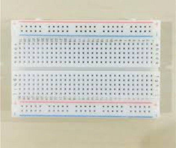

Photo of a white solderless breadboard with rows of square contact holes, red and blue power rail lines along the top and bottom, and a centre channel dividing the two halves.
Maybe you can use a breadboard,I personally think that it is better at “debugging” the circuit in development stages,since it doesn’t require soldering.
  • Photo of a white solderless breadboard with rows of square contact holes, red and blue power rail lines along the top and bottom, and a centre channel dividing the two halves.

View attachment 230682 Maybe you can use a breadboard,I personally think that it is better at “debugging” the circuit in development stages,since it doesn’t require soldering.
That breadboard system strikes me as being a bit like Lego. Lego is easy to throw together and there is no limit to the number of non-working models possible but it can come apart under very low stress; the models have to be treated with great care. The only thing in favour of the breadboard system seems to be that you don't need to use solder. But solder is such an easy medium to use (since they invented the flux-cored version in the 1950's or before) and it takes no time at all to get skilled at using it. I guess it can be a pain to use if your constructions are on a desk in your bedroom. A hot iron can burn other favourite toys but a bit of care is all that's needed.

Breadboarding is probably the best for debugging a design. Push parts in and push wires in. Dont like something, just pull the wire and move it.

The bigger problem now is most parts are surface mount, so wire wrapping and breadboarding, wirk with through hole parts, so you need little breakout boards that convert smd parts to throughhole.
