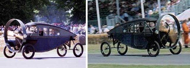

You not good me understand. I not say 100 l for car and 70 l for prop. I say 100 l for propeller powered car and 70 l for normal car.
Aero car (propeller powered car):
Code:
Why do you think this is calculating the propellor efficiency?
How other?
3. What do you think the propellor efficiency acutally is, as you seem to be using a different definition to every textbook I've ever read on the subject?
Car powered propeller must be like normal car.
This car good:
This car powered propeller not good for experiment, because is not like normal car:
Your calculation is crap. The above post is similarly pointless to furthering your argument.
