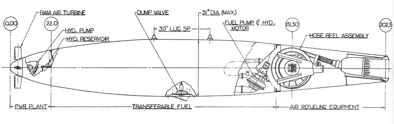

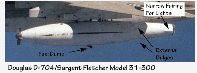

I was watching some videos of aircraft carrier cat shots of fighter jets today (don't ask), and was surprised to see in a slow-motion closeup shot that one of the underwing pods on an FA-18 had a propeller spinning on its nose.
That seemed pretty strange to me, so I did some Google searching, and it looks like the pod is used for in-flight refuelling of other aircraft (?). But why would you use a propeller for powering such a pod instead of just drawing the power from the host aircraft?
http://tailspintopics.blogspot.com/2015/06/things-under-wings-inflight-refueling.html

The diagram in your link seems to indicate that the Ram Air Turbine (RAT) provides hydraulic pressure to power the fuel pump.

That's what's called a "Buddy Store" and its meant to be a completely self-contained unit to provide refueling capacity to an existing aircraft with only minor wiring changes to accommodate the needed controls. As others have mentioned, the propeller is a ram air turbine for powering the pod's hydraulics and electronics. IIRC, they were originally developed for use with the A-4 Skyhawk, which could carry a frankly ridiculous amount of external fuel for such a tiny plane, but the concept lives on today for use with the FA-18E/F Super Hornets for use as tankers on carriers.
Similar RATs are found on the front of the ALQ-99 electronic warfare pods used by the EA-18G Growler (and the EA-6B Prowler before it). They provide the required electrical power to drive the systems on the pods without requiring additional power generation on the host platform.
In both cases, it actually reduces the complexity of integrating such a system onto an existing aircraft, and today it's literally just "plug and play". There's no need to tap into the hydraulic system of the host aircraft, no need to run high power electrical wiring to the pylon. Just some extra light-duty wiring for communication between store and aircraft. The aircraft's stores management system on modern aircraft already knows how to interface with the Buddy Store and can display the correct menus and send/receive the correct information via the databus, and no additional wiring or plumbing is required.
