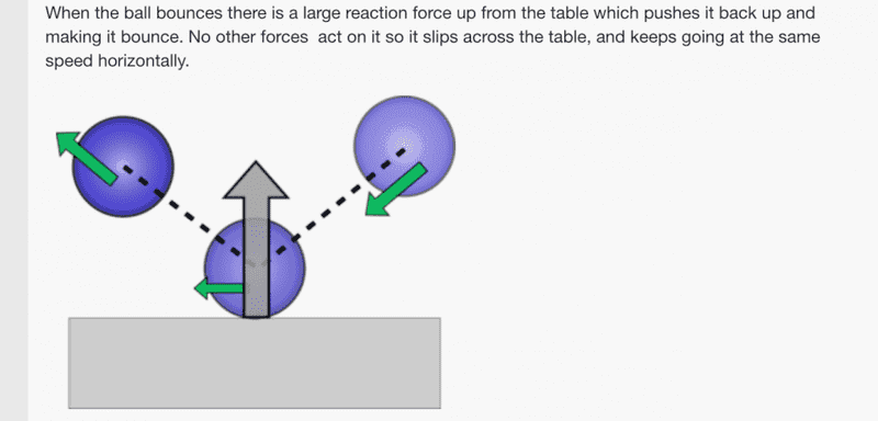

So here is a case where a ball is thrown on the floor with no friction.
Diagram of a ball bouncing off a table: three ball positions with dashed lines, green velocity arrows, and a grey vertical reaction force arrow at the contact point; text above describes the reaction force and horizontal sliding.

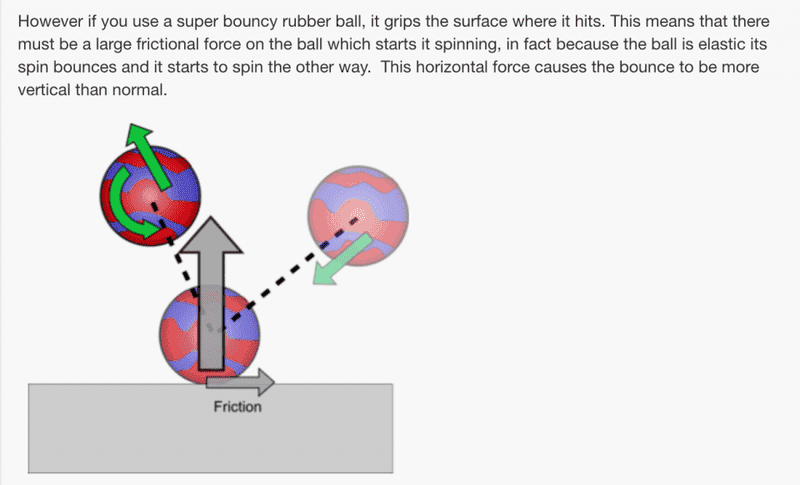

Then is a case with friction
Diagram of a bouncing ball striking a surface: a grey arrow shows the normal force upward, a grey arrow labelled Friction points right along the surface, and the ball's spin is shown by green arrows.
Now what I don't understand is how is the presence of friction going to make the normal force larger than usual. The friction is dependent on the normal force, not the other way around. And the normal force is dependent on the vertical impulse, which should the same as the previous case, since the CM of the ball has the same final vertical velocity before impact.
Well there is angular momentum, the ball when it hits a surface with friction will convert angular momentum into deformation so that would account for an additional boost.
You are correct. The normal force would not be larger than normal. But I think that you are misinterpreting the drawing. It is not intended to show that the bounce is reaches a higher maximum height than normal. It is intended to show that the bounce angle is higher than normal.
You can achieve a higher bounce angle in either of two ways: By reducing the horizontal velocity or by increasing the vertical velocity. The text speaks of the former and not the latter.

Oh ok. That makes sense. The height must be the same, so the reduced distance(due to friction) traveled in the x direction would cause the hypotenuse to be angled higher.
