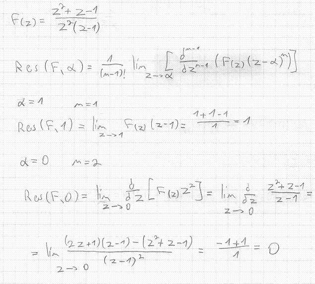

Ok, this is what I did (in the pic).
Now I need to sum the residues to get the answer?
Thanks.
The answer to what question? In your original post you only asked about the residues themselves.
If the problem is to find the integral around a closed path having both z= 0 and z= 1 in its interior then the integral is the sum of the residues times [itex]2\pi i[/itex].
If the problem is to find the integral around a closed path that contains z= 0 but not z= 1 in its interior then the integral is the residue at z= 0 times [itex]2\pi i[/itex].
If the problem is to find the integral around a closed path that contain z= 1 but not z= 0 in its interior then the integral is the residue at z= 1 times [itex]2\pi i[/itex].
To be complete, if the problem is to find the integral around a closed path that contains neither z= 0 nor z= 1 in its interior then the integral is 0, of course.
