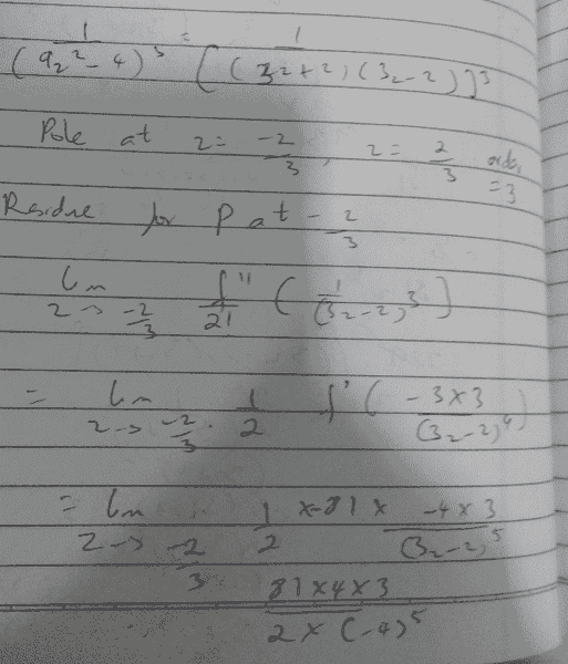

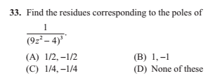

First find poles and then use residue theorem.
Book answer is A. But there's no way I'm getting A. The 81 in numerator doesn't cancel off.

Be careful. You don't multiply the function by ##(3z+2)^3## before you differentiate it. What's the correct factor? You won't get the books answer A in any case, but that's the books problem.

I don't get your answer or any of the answers above. It's hard for me to read your writing.
The (3z+2)3 will get canceled when I find residue at z = -2/3, just like the (3z-2)3 part will get canceled when I find residue at z = 2/3.
The residue formula has ##(z-a)^3## where ##a=(-2/3)##. That's not ##(3z+2)^3##.
Yeah you're right. In solved example they've broken 0.5z - 1.5i to z - 3j and multiplied 2 into numerator. Thanks.
