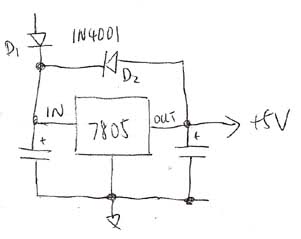

Don't worry about the source impedance. THis is the circuit you can build:
It is important to have D2 to protect the regulator. One thing concerning is the power disipation of the regulator. you drop 12-5=7V across the 7805, it you draw 1A, that will be 7W! I would either put 5 diodes in series for D1 to help dropping 3.5V to lower the power by half. Or if you want to, buy the 78SR05 switching regulator equivalent instead. I think the company making this is Power Trend.
Thank you so much guys, you answered all my questions!
