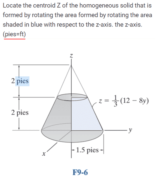

Locate the centroid Z of the homogeneous solid that is formed by rotating the area formed by rotating the area shaded in blue with respect to the z-axis. the z-axis.
## \overline{z}=\frac{\int _{ }^{ }\tilde{z}dA}{\int _{ }^{ }dA} ##
## A_b=πr^2 ##
This is the picture of the problem.

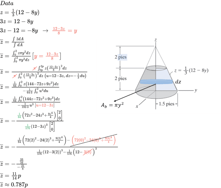

My solution is:
I'm not sure if the limit is 0 to 2 or 0 to 4...
Would your expressions for the integrands be valid above z=2?
There is a way to solve it without calculus if you know the formula for the centroid of a cone.

The denominator in your fifth equation gives the volume as ##\int_0^2\pi y^2dz##. That is based on an element thickness dz at height z having volume ##\pi y^2dz##.
In the figure, does the solid have a volume element of that size between ##z## and ##z+dz## for all z in ##(0,4)##?

Yes, but you asked what the bounds should be on the integrations, (0,2) or (0,4).
The range of integration should not extend beyond where the expression for the integrand represents a contribution to the desired total. In the region z>2, are there volume elements contributing to the total volume of the shaded region? If not, the range should stop at 2.

Of which the simplest is that for a conical form extending from a plane base to a point the distance of the mass centre from the base is 1/4 the distance of the point from the base.
Can you see how to use that here to get the answer quickly?

Yes. The concept is finding the mass centre of an object by representing it as the sum or difference of simpler objects.
In this case, the object is the difference between two complete cones.
You can write down where the mass centre of each complete cone is, and you know their relative masses.
Can you take it from there?

For the two cubes problem, take moments about a point in the middle of the base of the lower cube. The result should be the same treating it as one object or two.
The masses of the cubes are 1 and 8 for a total of 9. The mass centre heights are 1 and 2.5. The combined moment is 1x2.5+8x1=11.5.
If the overall mass centre is height Y then 11.5=9Y, so Y=11.5/9.
The frustrated cone in the problem in post 1 can be represented as the difference of two cones.
