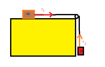

How do i motivate that T1 = T2 in this system.
without just saying "Oh" its the same rope, like more in depth "why"

By assuming that the rope is massless.

Well, your diagram is open to some interpretation. Is it a static figure? Is there friction present for the surface on which M rests? Are D and M supposed to have the same mass?
If you draw a free body diagram which isolates the sheave, you should be able to determine how T1 relates to T2, assuming of course, you can answer the questions posed above.

Well, the easy answer is it's the same rope. When you pull on one end with a certain amount of force, that same force is transmitted all the way back to the point where the other end of the rope is attached. That's the First Law of Ropes.
