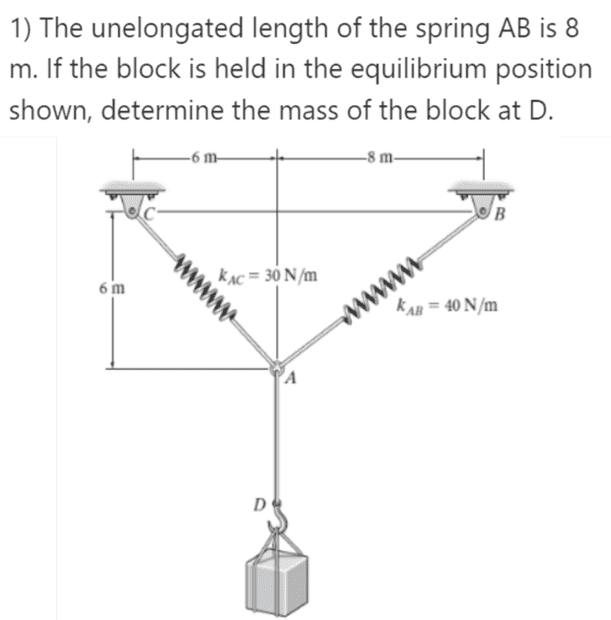

1) The non-elongated length of the spring AB is 8 m. If the block is held in the equilibrium position equilibrium position shown, determine the mass of the block at D.

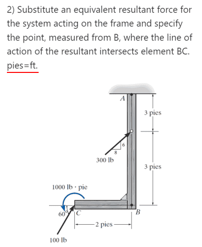

2) Replace the system acting on the frame by an equivalent resultant force and specify the point, measured from B, where the line of action of the resultant intersects element BC.
1) Σfx=0, Σfy=0 and F=kx
2) Σfx=0, Σfy=0, Θ=arctan(Σfy/Σfx) and ΣMb=Mrb
Diagram of a block hung from point A by two springs, AC with stiffness 30 N/m and AB with stiffness 40 N/m, attached to supports C and B; labels show 6 m, 8 m and 6 m dimensions and the block at D.
I tried to solve it and I got the following is it correct?
<math xmlns=http://www.w3.org/1998/Math/MathML display=block data-is-equatio=1 data-latex=\begin{array}{l}------------------\\
Hypotenuse\ 1_{AC}\\
h_{AC}=\sqrt{6^2+6^2}\\
h_{AC}=6\sqrt{2}\\
Hypotenuse\ 2_{AB}\ \\
h_{AB}=\sqrt{6^2+8^2}\\
h_{AB}=10\\
F_r=\left(l_f-l_i\right)\cdot k\ \\
F_{AB}=\left(10-8\right)\cdot40\ \\
\left[F_{AB}=80\right]\\
Σfx=0\\
F_{AB}\left(\frac{8}{10}\right)-F_{AC}\left(\frac{6}{6\sqrt{2}}\right)=0\\
80\left(\frac{8}{10}\right)-F_{AC}\left(\frac{1}{\sqrt{2}}\right)=0\\
F_{AC}\left(\frac{1}{\sqrt{2}}\right)=80\left(\frac{8}{10}\right)\\
F_{AC}=80\left(\frac{8\sqrt{2}}{10}\right)\\
\left[F_{AC}=90.51\right]\\
Σfy=0\\
F_{AB}\left(\frac{6}{10}\right)+F_{AC}\left(\frac{6}{6\sqrt{2}}\right)-D=0\\
80\left(\frac{6}{10}\right)+90.51\left(\frac{1}{\sqrt{2}}\right)-D=0\\
D=80\left(\frac{6}{10}\right)+90.51\left(\frac{1}{\sqrt{2}}\right)\\
\left[D=112=w\right]\\
m=\frac{w}{g}\\
m=\frac{112}{9.8}\\
\left[m=11.42kg\right]\\
------------------\end{array}><mtable columnalign=left columnspacing=1em rowspacing=4pt><mtr><mtd><mo>−</mo><mo>−</mo><mo>−</mo><mo>−</mo><mo>−</mo><mo>−</mo><mo>−</mo><mo>−</mo><mo>−</mo><mo>−</mo><mo>−</mo><mo>−</mo><mo>−</mo><mo>−</mo><mo>−</mo><mo>−</mo><mo>−</mo><mo>−</mo></mtd></mtr><mtr><mtd><mi>H</mi><mi>y</mi><mi>p</mi><mi>o</mi><mi>t</mi><mi>e</mi><mi>n</mi><mi>u</mi><mi>s</mi><mi>e</mi><mtext></mtext><msub><mn>1</mn><mrow data-mjx-texclass=ORD><mi>A</mi><mi>C</mi></mrow></msub></mtd></mtr><mtr><mtd><msub><mi>h</mi><mrow data-mjx-texclass=ORD><mi>A</mi><mi>C</mi></mrow></msub><mo>=</mo><msqrt><msup><mn>6</mn><mn>2</mn></msup><mo>+</mo><msup><mn>6</mn><mn>2</mn></msup></msqrt></mtd></mtr><mtr><mtd><msub><mi>h</mi><mrow data-mjx-texclass=ORD><mi>A</mi><mi>C</mi></mrow></msub><mo>=</mo><mn>6</mn><msqrt><mn>2</mn></msqrt></mtd></mtr><mtr><mtd><mo>−</mo><mo>−</mo><mo>−</mo><mo>−</mo><mo>−</mo><mo>−</mo><mo>−</mo><mo>−</mo><mo>−</mo><mo>−</mo><mo>−</mo><mo>−</mo><mo>−</mo><mo>−</mo><mo>−</mo><mo>−</mo><mo>−</mo><mo>−</mo></mtd></mtr><mtr><mtd><mi>H</mi><mi>y</mi><mi>p</mi><mi>o</mi><mi>t</mi><mi>e</mi><mi>n</mi><mi>u</mi><mi>s</mi><mi>e</mi><mtext></mtext><msub><mn>2</mn><mrow data-mjx-texclass=ORD><mi>A</mi><mi>B</mi></mrow></msub><mtext></mtext></mtd></mtr><mtr><mtd><msub><mi>h</mi><mrow data-mjx-texclass=ORD><mi>A</mi><mi>B</mi></mrow></msub><mo>=</mo><msqrt><msup><mn>6</mn><mn>2</mn></msup><mo>+</mo><msup><mn>8</mn><mn>2</mn></msup></msqrt></mtd></mtr><mtr><mtd><msub><mi>h</mi><mrow data-mjx-texclass=ORD><mi>A</mi><mi>B</mi></mrow></msub><mo>=</mo><mn>10</mn></mtd></mtr><mtr><mtd><mo>−</mo><mo>−</mo><mo>−</mo><mo>−</mo><mo>−</mo><mo>−</mo><mo>−</mo><mo>−</mo><mo>−</mo><mo>−</mo><mo>−</mo><mo>−</mo><mo>−</mo><mo>−</mo><mo>−</mo><mo>−</mo><mo>−</mo><mo>−</mo></mtd></mtr><mtr><mtd><msub><mi>F</mi><mi>r</mi></msub><mo>=</mo><mrow data-mjx-texclass=INNER><mo data-mjx-texclass=OPEN>(</mo><msub><mi>l</mi><mi>f</mi></msub><mo>−</mo><msub><mi>l</mi><mi>i</mi></msub><mo data-mjx-texclass=CLOSE>)</mo></mrow><mo>⋅</mo><mi>k</mi><mtext></mtext></mtd></mtr><mtr><mtd><msub><mi>F</mi><mrow data-mjx-texclass=ORD><mi>A</mi><mi>B</mi></mrow></msub><mo>=</mo><mrow data-mjx-texclass=INNER><mo data-mjx-texclass=OPEN>(</mo><mn>10</mn><mo>−</mo><mn>8</mn><mo data-mjx-texclass=CLOSE>)</mo></mrow><mo>⋅</mo><mn>40</mn><mtext></mtext></mtd></mtr><mtr><mtd><mrow data-mjx-texclass=INNER><mo data-mjx-texclass=OPEN>[</mo><msub><mi>F</mi><mrow data-mjx-texclass=ORD><mi>A</mi><mi>B</mi></mrow></msub><mo>=</mo><mn>80</mn><mo data-mjx-texclass=CLOSE>]</mo></mrow></mtd></mtr><mtr><mtd><mo>−</mo><mo>−</mo><mo>−</mo><mo>−</mo><mo>−</mo><mo>−</mo><mo>−</mo><mo>−</mo><mo>−</mo><mo>−</mo><mo>−</mo><mo>−</mo><mo>−</mo><mo>−</mo><mo>−</mo><mo>−</mo><mo>−</mo><mo>−</mo></mtd></mtr><mtr><mtd><mi>Σ</mi><mi>f</mi><mi>x</mi><mo>=</mo><mn>0</mn></mtd></mtr><mtr><mtd><msub><mi>F</mi><mrow data-mjx-texclass=ORD><mi>A</mi><mi>B</mi></mrow></msub><mrow data-mjx-texclass=INNER><mo data-mjx-texclass=OPEN>(</mo><mfrac><mn>8</mn><mn>10</mn></mfrac><mo data-mjx-texclass=CLOSE>)</mo></mrow><mo>−</mo><msub><mi>F</mi><mrow data-mjx-texclass=ORD><mi>A</mi><mi>C</mi></mrow></msub><mrow data-mjx-texclass=INNER><mo data-mjx-texclass=OPEN>(</mo><mfrac><mn>6</mn><mrow><mn>6</mn><msqrt><mn>2</mn></msqrt></mrow></mfrac><mo data-mjx-texclass=CLOSE>)</mo></mrow><mo>=</mo><mn>0</mn></mtd></mtr><mtr><mtd><mn>80</mn><mrow data-mjx-texclass=INNER><mo data-mjx-texclass=OPEN>(</mo><mfrac><mn>8</mn><mn>10</mn></mfrac><mo data-mjx-texclass=CLOSE>)</mo></mrow><mo>−</mo><msub><mi>F</mi><mrow data-mjx-texclass=ORD><mi>A</mi><mi>C</mi></mrow></msub><
and 2
Structural frame diagram with a bent member: a vertical segment labeled A at top and B at bottom, a horizontal segment ending at point C, a 300 lb force at A with slope 8 and 6 marked, a 1000 lb-ft couple at C, a 100 lb force at the lower left, a 60 degree angle, and 3 ft and 2 ft dimensions.
My solution... is a negative distance?
<math xmlns=http://www.w3.org/1998/Math/MathML display=block data-is-equatio=1 data-latex=\begin{array}{l}----------------------\\
hypotenuse\\
h=\sqrt{6^2+8^2}\\
h=10\\
F_{rx}=Σfx\\
300\left(\frac{8}{10}\right)+100\cos\left(60\right)=Σfx\\
\left[\textcolor{#E94D40}{290=Σfx}\right]\\
F_{ry}=Σfy\\
300\left(\frac{6}{10}\right)+100\sin\left(60\right)=Σfy\\
\left[\textcolor{#E94D40}{267=Σfy}\right]\\
Σr=\sqrt{290^2+267^2}\\
Σr=394.2\\
Θ=\arctan\left(\frac{267}{290}\right)\\
Θ=42.64°\\
\end{array}><mtable columnalign=left columnspacing=1em rowspacing=4pt><mtr><mtd><mo>−</mo><mo>−</mo><mo>−</mo><mo>−</mo><mo>−</mo><mo>−</mo><mo>−</mo><mo>−</mo><mo>−</mo><mo>−</mo><mo>−</mo><mo>−</mo><mo>−</mo><mo>−</mo><mo>−</mo><mo>−</mo><mo>−</mo><mo>−</mo><mo>−</mo><mo>−</mo><mo>−</mo><mo>−</mo></mtd></mtr><mtr><mtd><mi>h</mi><mi>y</mi><mi>p</mi><mi>o</mi><mi>t</mi><mi>e</mi><mi>n</mi><mi>u</mi><mi>s</mi><mi>e</mi></mtd></mtr><mtr><mtd><mi>h</mi><mo>=</mo><msqrt><msup><mn>6</mn><mn>2</mn></msup><mo>+</mo><msup><mn>8</mn><mn>2</mn></msup></msqrt></mtd></mtr><mtr><mtd><mi>h</mi><mo>=</mo><mn>10</mn></mtd></mtr><mtr><mtd><mo>−</mo><mo>−</mo><mo>−</mo><mo>−</mo><mo>−</mo><mo>−</mo><mo>−</mo><mo>−</mo><mo>−</mo><mo>−</mo><mo>−</mo><mo>−</mo><mo>−</mo><mo>−</mo><mo>−</mo><mo>−</mo><mo>−</mo><mo>−</mo><mo>−</mo><mo>−</mo><mo>−</mo><mo>−</mo></mtd></mtr><mtr><mtd><msub><mi>F</mi><mrow data-mjx-texclass=ORD><mi>r</mi><mi>x</mi></mrow></msub><mo>=</mo><mi>Σ</mi><mi>f</mi><mi>x</mi></mtd></mtr><mtr><mtd><mn>300</mn><mrow data-mjx-texclass=INNER><mo data-mjx-texclass=OPEN>(</mo><mfrac><mn>8</mn><mn>10</mn></mfrac><mo data-mjx-texclass=CLOSE>)</mo></mrow><mo>+</mo><mn>100</mn><mi>cos</mi><mo data-mjx-texclass=NONE>⁡</mo><mrow data-mjx-texclass=INNER><mo data-mjx-texclass=OPEN>(</mo><mn>60</mn><mo data-mjx-texclass=CLOSE>)</mo></mrow><mo>=</mo><mi>Σ</mi><mi>f</mi><mi>x</mi></mtd></mtr><mtr><mtd><mrow data-mjx-texclass=INNER><mo data-mjx-texclass=OPEN>[</mo><mstyle mathcolor=#E94D40><mn>290</mn><mo>=</mo><mi>Σ</mi><mi>f</mi><mi>x</mi></mstyle><mo data-mjx-texclass=CLOSE>]</mo></mrow></mtd></mtr><mtr><mtd><msub><mi>F</mi><mrow data-mjx-texclass=ORD><mi>r</mi><mi>y</mi></mrow></msub><mo>=</mo><mi>Σ</mi><mi>f</mi><mi>y</mi></mtd></mtr><mtr><mtd><mn>300</mn><mrow data-mjx-texclass=INNER><mo data-mjx-texclass=OPEN>(</mo><mfrac><mn>6</mn><mn>10</mn></mfrac><mo data-mjx-texclass=CLOSE>)</mo></mrow><mo>+</mo><mn>100</mn><mi>sin</mi><mo data-mjx-texclass=NONE>⁡</mo><mrow data-mjx-texclass=INNER><mo data-mjx-texclass=OPEN>(</mo><mn>60</mn><mo data-mjx-texclass=CLOSE>)</mo></mrow><mo>=</mo><mi>Σ</mi><mi>f</mi><mi>y</mi></mtd></mtr><mtr><mtd><mrow data-mjx-texclass=INNER><mo data-mjx-texclass=OPEN>[</mo><mstyle mathcolor=#E94D40><mn>267</mn><mo>=</mo><mi>Σ</mi><mi>f</mi><mi>y</mi></mstyle><mo data-mjx-texclass=CLOSE>]</mo></mrow></mtd></mtr><mtr><mtd><mo>−</mo><mo>−</mo><mo>−</mo><mo>−</mo><mo>−</mo><mo>−</mo><mo>−</mo><mo>−</mo><mo>−</mo><mo>−</mo><mo>−</mo><mo>−</mo><mo>−</mo><mo>−</mo><mo>−</mo><mo>−</mo><mo>−</mo><mo>−</mo><mo>−</mo><mo>−</mo><mo>−</mo><mo>−</mo></mtd></mtr><mtr><mtd><mi>Σ</mi><mi>r</mi><mo>=</mo><msqrt><msup><mn>290</mn><mn>2</mn></msup><mo>+</mo><msup><mn>267</mn><mn>2</mn></msup></msqrt></mtd></mtr><mtr><mtd><mi>Σ</mi><mi>r</mi><mo>=</mo><mn>394.2</mn></mtd></mtr><mtr><mtd><mi>Θ</mi><mo>=</mo><mi>arctan</mi><mo data-mjx-texclass=NONE>⁡</mo><mrow data-mjx-texclass=INNER><mo data-mjx-texclass=OPEN>(</mo><mfrac><mn>267</mn><mn>290</mn></mfrac><mo data-mjx-texclass=CLOSE>)</mo></mrow></mtd></mtr><mtr><mtd><mi>Θ</mi><mo>=</mo><mn>42.64</mn><mrow data-mjx-texclass=ORD><mo data-mjx-pseudoscript=true>°</mo></mrow></mtd></mtr><mtr><mtd><mo>−</mo><mo>−</mo><mo>−</mo><mo>−</mo><mo>−</mo><mo>−</mo><mo>−</mo><mo>−</mo><mo>−</mo><mo>−</mo><mo>−</mo><mo>−</mo><mo>−</mo><mo>−</mo><mo>−</mo><mo>−</mo><mo>−</mo><mo>−</mo><mo>−</mo><mo>−</mo><mo>−</mo><mo>−</mo></mtd></mtr></mtable></math>
Structural diagram of an L-shaped frame with points A, B and C on x and y axes, labeled 3 pies, 2 pies, 1000 lb pie moment, 60 degree angle, 300 lb and 100 lb forces, and a 10 force with arrows.
ΣM_b=1000-300\left(\frac{8}{10}\right)\cdot3-100sen\left(60\right)\cdot2\\
\left[\textcolor{#E94D40}{ΣM_b=106.79lb_p}\right]\\
\left[\textcolor{#E94D40}{Mr_b=-267\cdot d}\right]\\
ΣM_b=Mr_b\\
106.79lb_p=-267\cdot d\\
-0.4p=d\\
----------------------\end{array}><mtable columnalign=left columnspacing=1em rowspacing=4pt><mtr><mtd><mo>−</mo><mo>−</mo><mo>−</mo><mo>−</mo><mo>−</mo><mo>−</mo><mo>−</mo><mo>−</mo><mo>−</mo><mo>−</mo><mo>−</mo><mo>−</mo><mo>−</mo><mo>−</mo><mo>−</mo><mo>−</mo><mo>−</mo><mo>−</mo><mo>−</mo><mo>−</mo><mo>−</mo><mo>−</mo></mtd></mtr><mtr><mtd><mi>Σ</mi><msub><mi>M</mi><mi>b</mi></msub><mo>=</mo><mn>1000</mn><mo>−</mo><mn>300</mn><mrow data-mjx-texclass=INNER><mo data-mjx-texclass=OPEN>(</mo><mfrac><mn>8</mn><mn>10</mn></mfrac><mo data-mjx-texclass=CLOSE>)</mo></mrow><mo>⋅</mo><mn>3</mn><mo>−</mo><mn>100</mn><mi>s</mi><mi>e</mi><mi>n</mi><mrow data-mjx-texclass=INNER><mo data-mjx-texclass=OPEN>(</mo><mn>60</mn><mo data-mjx-texclass=CLOSE>)</mo></mrow><mo>⋅</mo><mn>2</mn></mtd></mtr><mtr><mtd><mrow data-mjx-texclass=INNER><mo data-mjx-texclass=OPEN>[</mo><mstyle mathcolor=#E94D40><mi>Σ</mi><msub><mi>M</mi><mi>b</mi></msub><mo>=</mo><mn>106.79</mn><mi>l</mi><msub><mi>b</mi><mi>p</mi></msub></mstyle><mo data-mjx-texclass=CLOSE>]</mo></mrow></mtd></mtr><mtr><mtd><mrow data-mjx-texclass=INNER><mo data-mjx-texclass=OPEN>[</mo><mstyle mathcolor=#E94D40><mi>M</mi><msub><mi>r</mi><mi>b</mi></msub><mo>=</mo><mo>−</mo><mn>267</mn><mo>⋅</mo><mi>d</mi></mstyle><mo data-mjx-texclass=CLOSE>]</mo></mrow></mtd></mtr><mtr><mtd><mo>−</mo><mo>−</mo><mo>−</mo><mo>−</mo><mo>−</mo><mo>−</mo><mo>−</mo><mo>−</mo><mo>−</mo><mo>−</mo><mo>−</mo><mo>−</mo><mo>−</mo><mo>−</mo><mo>−</mo><mo>−</mo><mo>−</mo><mo>−</mo><mo>−</mo><mo>−</mo><mo>−</mo><mo>−</mo></mtd></mtr><mtr><mtd><mi>Σ</mi><msub><mi>M</mi><mi>b</mi></msub><mo>=</mo><mi>M</mi><msub><mi>r</mi><mi>b</mi></msub></mtd></mtr><mtr><mtd><mn>106.79</mn><mi>l</mi><msub><mi>b</mi><mi>p</mi></msub><mo>=</mo><mo>−</mo><mn>267</mn><mo>⋅</mo><mi>d</mi></mtd></mtr><mtr><mtd><mo>−</mo><mn>0.4</mn><mi>p</mi><mo>=</mo><mi>d</mi></mtd></mtr><mtr><mtd><mo>−</mo><mo>−</mo><mo>−</mo><mo>−</mo><mo>−</mo><mo>−</mo><mo>−</mo><mo>−</mo><mo>−</mo><mo>−</mo><mo>−</mo><mo>−</mo><mo>−</mo><mo>−</mo><mo>−</mo><mo>−</mo><mo>−</mo><mo>−</mo><mo>−</mo><mo>−</mo><mo>−</mo><mo>−</mo></mtd></mtr></mtable></math>
I confirm both your answers, but there are easier ways.
1. The horizontal and vertical components of the force in AC must be equal, so you can write the weight equals ##F_{AB}(\frac 35+\frac 45)##.
2. Suppose the point is x to the left of B and write that the net torque about that point is zero:
##-\frac 453(300)+\frac 35x(300)+1000+\frac{\sqrt 3}22(100)(x-2)=0##.
Whoops, typo. Should be ##-\frac 453(300)+\frac 35x(300)+1000+\frac{\sqrt 3}2(100)(x-2)=0##
As a matter of general style, I strongly recommend keeping everything symbolic until the final step, creating symbols as necessary for given numerical values. It has many advantages, including, often, less arithmetic and greater precision.
Ok, I violated my own principle just above, but if you had created symbols for the forces and lengths I would have preferred to use them.
bruh, I can barely understand what I'm doing enough to apply other formulas... sad.
in 3/5*x*300 generates angular momentum at b?
also by doing your formula I get a different value at x and it is also positive.
No, but we are interested in the moment about a point distance x to the left of B. Both horizontal and vertical components of the 300lb force can have a moment about that.
I made a typo in the LaTeX, doubling up a 2. See the corrected post.
oooh, indeed the result is the same, is a negative distance logical?
how do you know that you can equal it to 0? do you have any video where you explain this method?
how do you get that sqrt(3)/2, and how do you know where to put x?
Sorry, this is the first time I see this method...
I understand that sin(60)=sqrt(3)/2
but cos(60)=1/2 how do you get a factor of sqrt(3)/2 then?
Suppose the equivalent force is F passing through the line BC at point P. The force has no moment about P, so the system of forces has no moment about P.
It certainly could turn out to be to the right of B. We know F's vertical component must be up the page, so the stronger the anticlockwise applied torque at C, the further to the right F must act.
It's the vertical component of the force at C. Since the horizontal component acts along BC, it can have no moment about P, but the vertical component will be distance x-2 to the left of P.
thank you for the clarifications.
