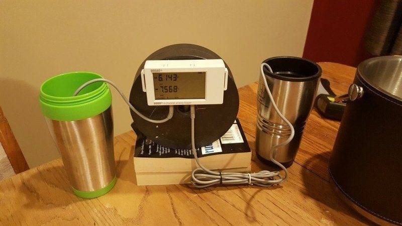

Ok, new experiment, designed to avoid the issue of the dissolving enthalpy and the issue of dilution as the ice melts. Also, we'll test both water/alcohol and water/salt:
Setup #1: 100 mL of water mixed with 50g of salt
Setup #2: 100 mL of Southern Comfort (50% alcohol by volume)
1. Refrigerate all components of the experiment. Ice is equalizing in an insulated ice bucket in the fridge as well.
2. Measure and record temperatures of both liquids.
3. Add ice to each.
4. Measure and record temperatures again.
At the start, the ice should be right at 0C and the water and alcohol should each be at a few degrees C. What happens when I add the ice?
  • #54
mfb said:
No ice will melt if both ice and drink are at 0 C, at least if we keep ice and drink separate the ice melting and freezing is in equilibrium. Mixing changes that, but there we are back to the mixing thing...
In a real drink and in both of the experiments I propose, there will be mixing -- so, what happens to the temperature of the mixtures?
  • #55
3. Add ice to each.
Test completed. Results:
Starting ice temp: about 0C
Starting Water/Salt Temp: 4.6C
Starting SoCo Temp: 5.0C
7 min Water/Salt Temp: -6.1C
7 min SoCo Temp: -7.6C
Incidentally, now after about 25 minutes, the temperatures are about the same, but the ice in the SoCo is noticeably more melted. You can probably tell, but that's probably because the green mug is substantially lower quality than the black one. Photo after 7 min and 3 videos:

Sure - though I am in agreement with mfb about what the result will be, and it is also a different experiment from what the OP was asking about.
I was wrong about one thing: The freezing point of 50% alcohol is -52C (I didn't look that up ahead of time) and with a starting point 57C higher and a poorly insulated mug, melting and dilution of the alcohol was a significant factor in the final temperature of the mix. The result was a substantial amount of melting and dilution and thus an equilibrium temperature that was not predictable (though I actually didn't try to predict in anyway beyond whether it would be above or below 0C). I may try that part of the experiment again as well, with ice and alcohol in my freezer. I'll by trying to get ice to melt at -20C or lower (as it does on a road when you add salt) and achieve a lower temperature than my freezer.
Note, the key result here was what several people said outright or implied could not happen: the mixture ended up at a temperature lower than either constituent started and lower than 0C.
