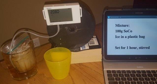

I bought a better mug and verified that insulation matters a lot. The melting rate of the ice (and therefore the internal heat transfer) drops as the temperature drops, which means you need really good insulation to approximate the adiabatic case. In reality, I only achieved -22C in a -18C freezer, despite a freezing point that should have been about -32C.

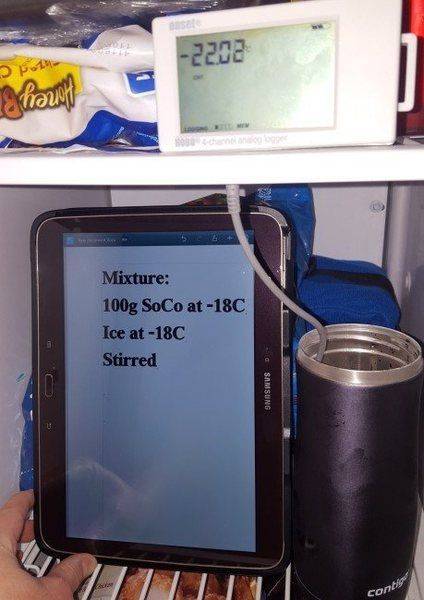

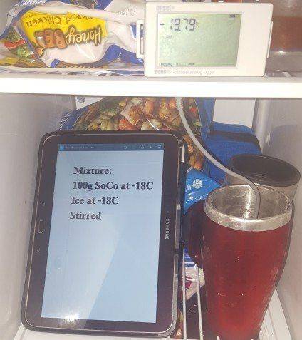

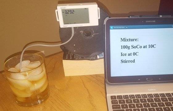

I did also do more tests, which I will share when I have time. Room temperature alcohol an excess ice at 0C does still yield a final temp below 0C. Both in the real world and the math, if you don't add enough ice (all the ice melts), just add more ice until you have some unmelted in the mixture. 0C is the highest possible temperature of such a mixture.
