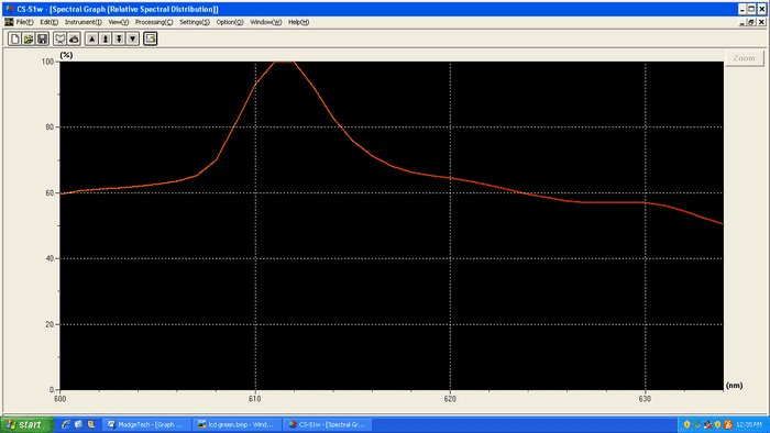

While the color filter has peak wavelengths of:
R: 611nm
G: 544nm
B: 448nm
Here is the Red:
Spectral graph of relative spectral distribution in percent against wavelength in nm, showing a single orange curve peaking near 611 nm at 100 percent, falling to about 50 percent at 635 nm.
The right border is set to 634nm, the peak of the LEDs we've been using. You can see that about 50% attenuation can be expected.

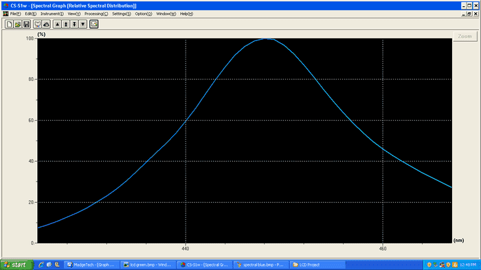

Blue:
Spectral graph of relative spectral distribution in percent against wavelength in nm, showing a single blue peak near 464 nm that falls to about 50% by 460 nm and about 28% near 468 nm.
The right border is set to 468nm, attenuation about 28%. OUCH.
