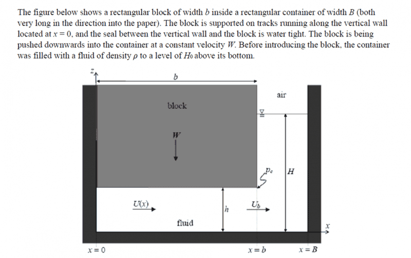

Hey everyone ! I'm new here and found that this forum was very useful. Would really appreciate it if you could help me out with this problem ! Have been scratching my head for hours now :(
Question:
Diagram of a rectangular block of width b inside a rectangular container of width B, with the block moving downward at velocity W, fluid of depth h below it, and air above the fluid surface at height H; labels show fluid velocity U(x), block-edge velocity Ub, pressure pe, and walls at x = 0 and x = B.

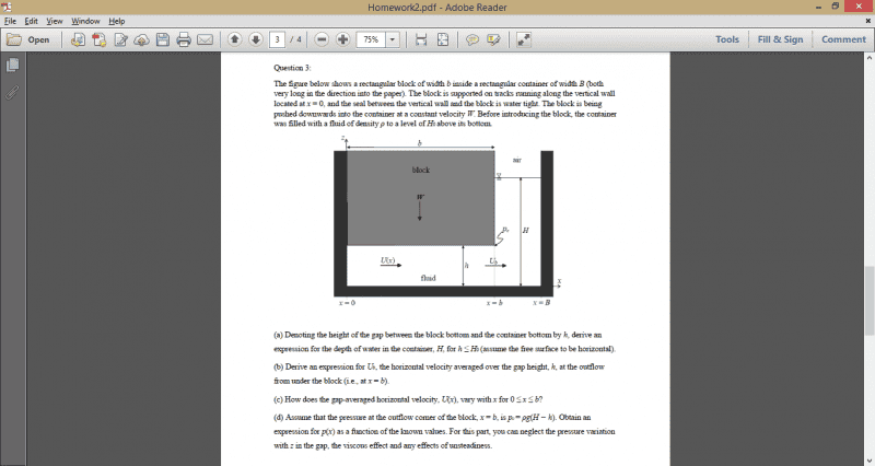

Text of a physics homework problem with parts (a) to (d) about water depth, gap-averaged horizontal velocity U(x), and pressure p(x) under a block with gap height h and outflow at x = b.

  • Diagram of a rectangular block of width b inside a rectangular container of width B, with the block moving downward at velocity W, a gap of height h at the bottom, fluid of depth H, and labels for x = 0, x = b and x = B.
The (a) part can be solved by conserving volume of the liquid . (Think about rate of change of volume !)
heya, A was okay actually. The main problems I have are with B onwards !

Okay, so I was told that my homework request was an unreasonable one and hence, I have looked through the forum rules. I shall abide by them ! So sorry for being ignorant.
See Above
Bernoulli Equation: V2/2g + p/dg + z = constant
V = velocity of particles flowing through that point of the streamline
g = acceleration due to gravity
p = pressure at that point of the streamline
d = density
z = elevation at that point of the streamline
(a) V = H0B = bh + (B-b)H
H=(BH0-bh)/(B-b)
(b) By conservation of volume,
Discharge, Q = W.Ab = Ub.Af
Q = W.b = Ub.h
Therefore, Ub = bW/h
(c) Since gap-averaged flow from x=0 to x=b is a well-behaved flow, dU(x)/dx = 0
(d)
At point x=b: Ub/2g + dg(H-h)/dg + h = constant
From here, I'm really not too sure how to proceed.
Any help would be greatly appreciated ! Thank you !
